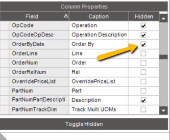

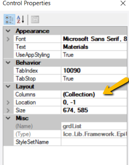

You have to customise your view in PO Suggestions. Open New PO Suggestions and do this:
  1. Tools on the menu > personalization
  2. Go to where the material list grid normally is
  3. Press on collection on the floating Control Properties window
  1. BE CAREFUL IN THIS SECTION. NEVER PRESS SHOW HIDDEN.
  2. Sort by field name and goto orderbydate. Uncheck hidden.
  1. Say OK and restart PO Suggestions when prompted.
  2. Bring in some data and go find the order by date column.
  3. Drag it to where you want it
  4. Right click in the window and press save layout.

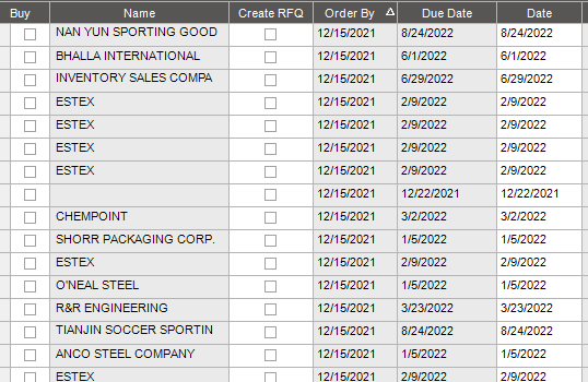

We have the Order By Date showing. I want the Required By Date.
In a perfect world the Required By Date is the same as the Due Date. But I don’t live in that world.
The Due Date tells us when Epicor thinks we can get it by based on the lead time of the part. It doesn’t tell use when we NEED it.
I want another column between the Order By and Due Date columns that tells me the Required By date.

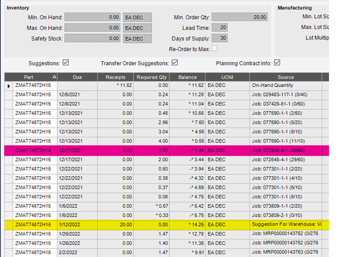

Here is a screen shot of Time Phase. We need more tomorrow. The New PO Suggestion has a due date of 1/12/22. Because IF we order it today, it will take 20 days for the parts to arrive (based on the lead time in Epicor). The price list lead time and the part plant lead time are both set to 20.

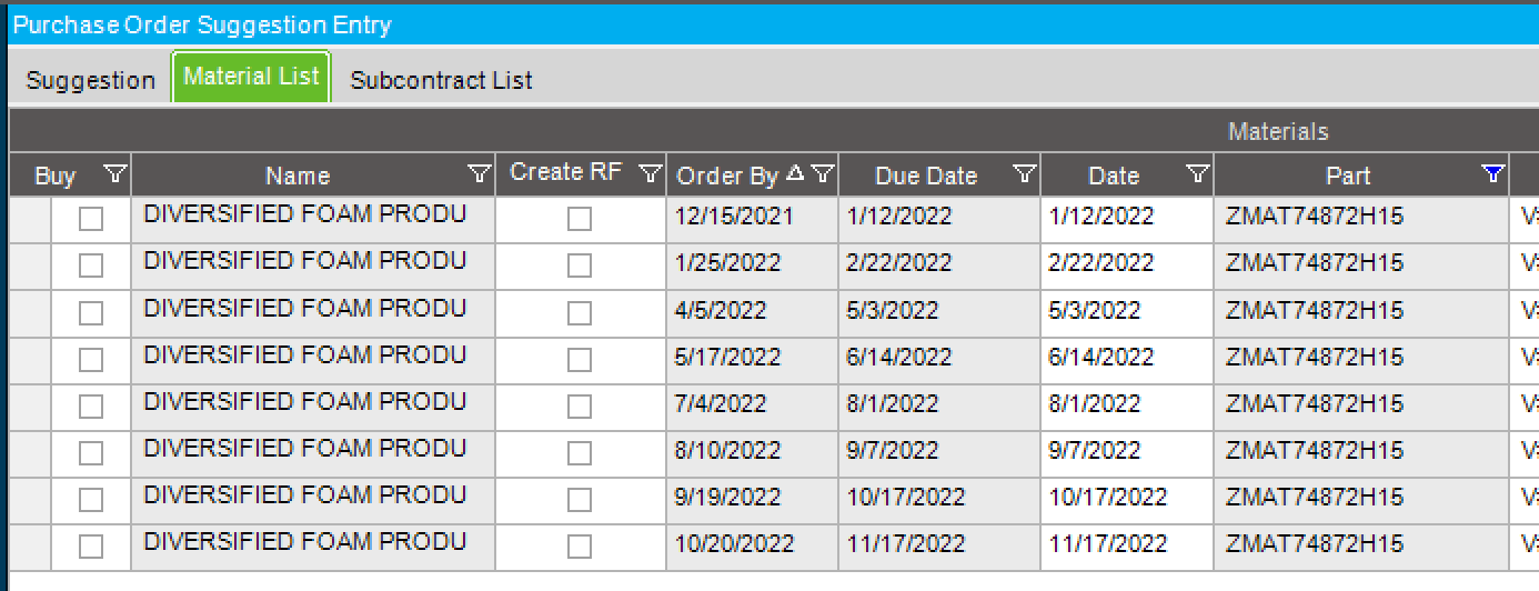

Here is a screen shot of the New Suggestion itself. (Note, the last time we ran MRP was last night)
