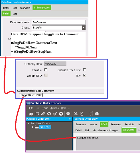

I once needed to keep track of suggestions in the PO.
I ended up using a data BPM to store the SugPoDtl.SugDtlNum in the comment so that it was automatically copied to the generated PO.
Not sure if you would be able to do something similar for getting a rfqsugg reference into the PO, I’m not too familiar with the data/mechanics of that table.
