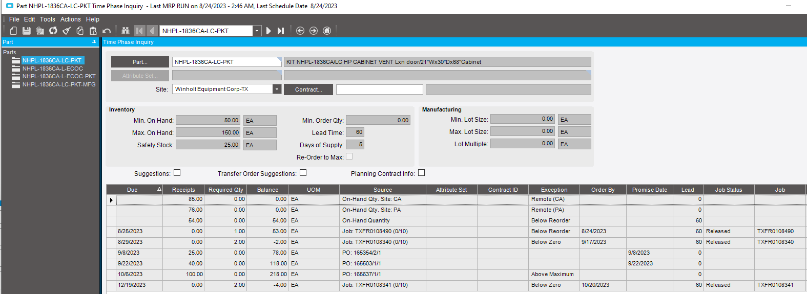

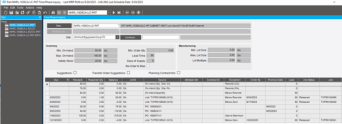

We have part# NHPL-1836CA-LC-PKT with 54 pieces onhand in TX. I am including the time phase screen to reference.
Job# TXFR0108490 requires 1 piece and decrements from Onhand to 53. The next 2 jobs require 2 pieces each, but decrement inventory showing -2, -4 respectively. Cannot figure why it would not decrement to 51, 49 respectively. Any ideas? Please ask for add’l information if needed to resolve.

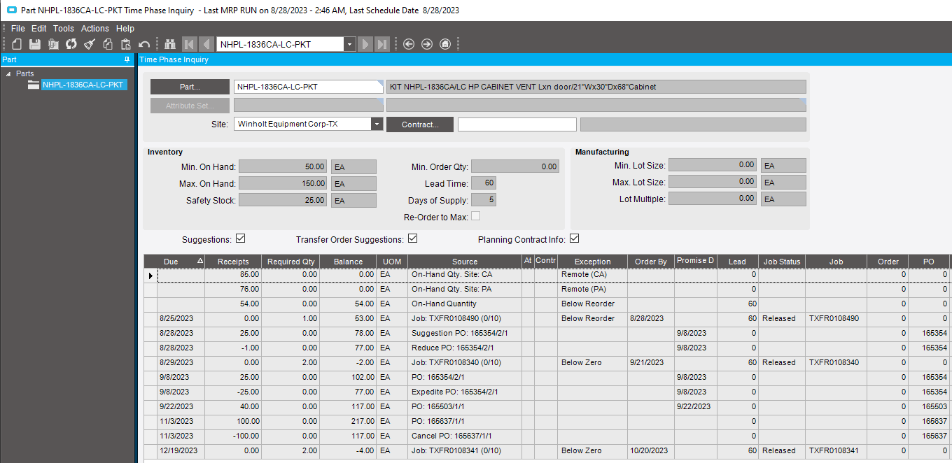

Do any additional details show if you check the “suggestion” checkboxes? Perhaps there are transfer suggestions, or cancel PO suggestions that aren’t being shown which could impact your running balance.
Wouldn’t make sense based on your min/max values… but just tossing out ideas to check.

Snapshot including suggestions:
