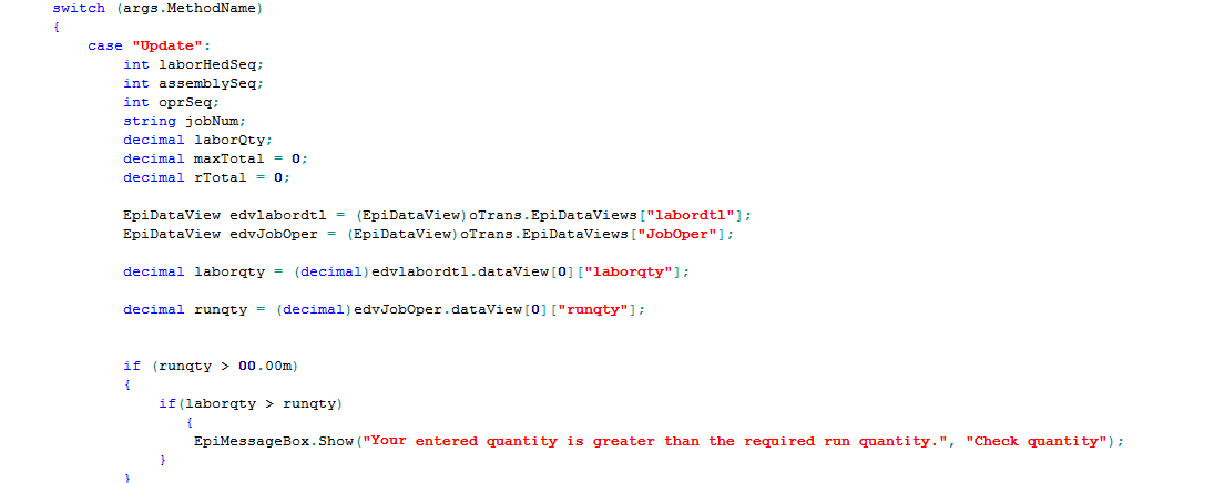

In MES I’m trying to capture the qty they put in when they end the job and compare it to the joboper runqty. It is giving me an object reference error on the edvlabordtl and edvjoboper. Kind of like it is missing a using statement.

If you’re only referencing EpiDataViews that already exist in the screen to set values, then you shouldn’t need to add any references in.
I would start by checking your references:
(EpiDataView)oTrans.EpiDataViews["labordtl"]; // Should this be LaborDtl ?
(decimal)edvlabordtl.dataView[0]["laborqty"]; // Should this be LaborQty ?
(decimal)edvJobOper.dataView[0]["runqty"]; // Should this be RunQty ?
The common theme to my observations is capitalisation. Needs to match exactly. Use either the Object Explorer or BL Tester to verify.
I made sure that it was the same casing, but I still get the object error.
