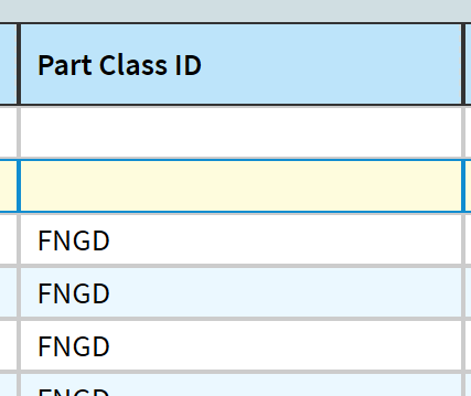

The data is populating, but when I click on the row / in the new column, data disappears, and it allows me to overwrite it.

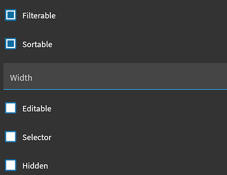

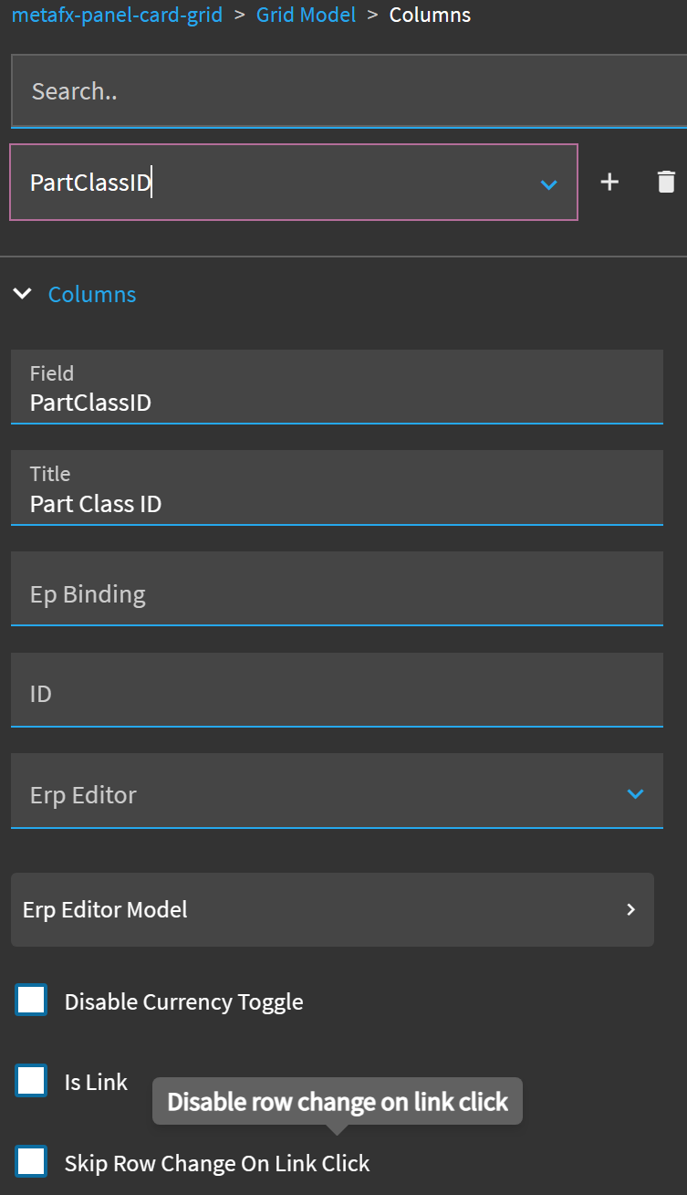

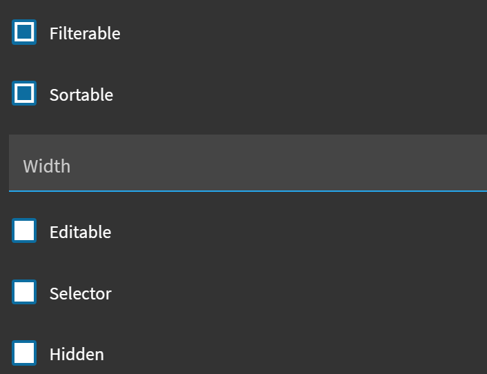

I did not check Editable, as this should be a readonly column, so unsure if this is just a Kinetic issue?
Here is the column setup:

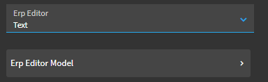

I wonder if you set up an Editor Model to make it explicitly read-only…
Set Erp Editor to the appropriate data type

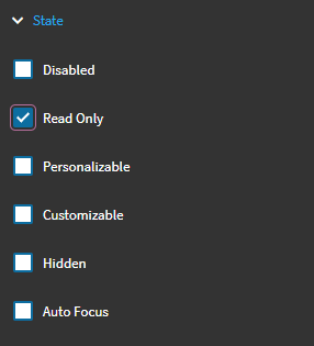

Then under Erp Editor Model, set the State to Read Only
Thank you! That helped stop the ability to type in there, so I appreciate the tip very much! However, it still wipes the data once I click the row. I wonder if it’s because of the type of grid?
Ex:
