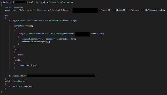

I have a classic client side customization that calls a SQL Stored Procedure in an external database, triggered by button click. This has been working for years but has been timing out in some scenarios lately. It’s somewhat heavy duty and ~30 seconds is a reasonable execution time in my opinion.
I’m of course looking to tune and improve performance on that stored proc, but also looking into increasing the timeout settings. Haven’t done much research on where those settings live / am I playing with fire by trying to adjust them…? Figured I’d start by asking the experts here! Below is the customization code for reference:

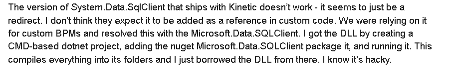

But honestly more recently I’ve used UD tables, BAQs and REST to call BAQSvc with better results than anything. Plus .NET SQLClient seems to go nuckin futz on me

If it runs under two minutes, you could try setting command.CommandTimeout = 120. But like other have mentioned this is not an ideal code pattern, using web service calls may be safer in the long run
Thanks for the ideas and comments everyone. Just confirming that setting the timeout in code worked splendidly.

I store all that in User Codes so at least it’s not in code, but it does bother me to store creds there even if the account has minimal permissions and I’m the only one who can see it… My plan for the next iteration of making this better is to move this from client customization to a Function running on the server so I can use Windows authentication more easily instead of SQL login username password…
It appears that you are opening a connection from the client. Depending on number of clients using this function, you might have extra connections to SQL Server. Despite all the claim from Microsoft, database has to manage the connection pools and execution plans. In addition, when you move to cloud, it could become a problem as well.
Any case, as others pointed out, it’s prudent to move it to an API wrapper.
