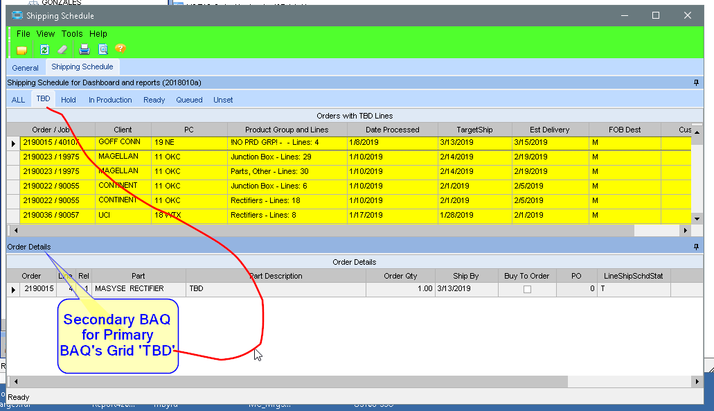

Pict of what you currently have?
I have the following which is really 1 Primary BAQ, but with 7 different grids, one each on a tab (All, TBD, Hold, In Production, etc…)

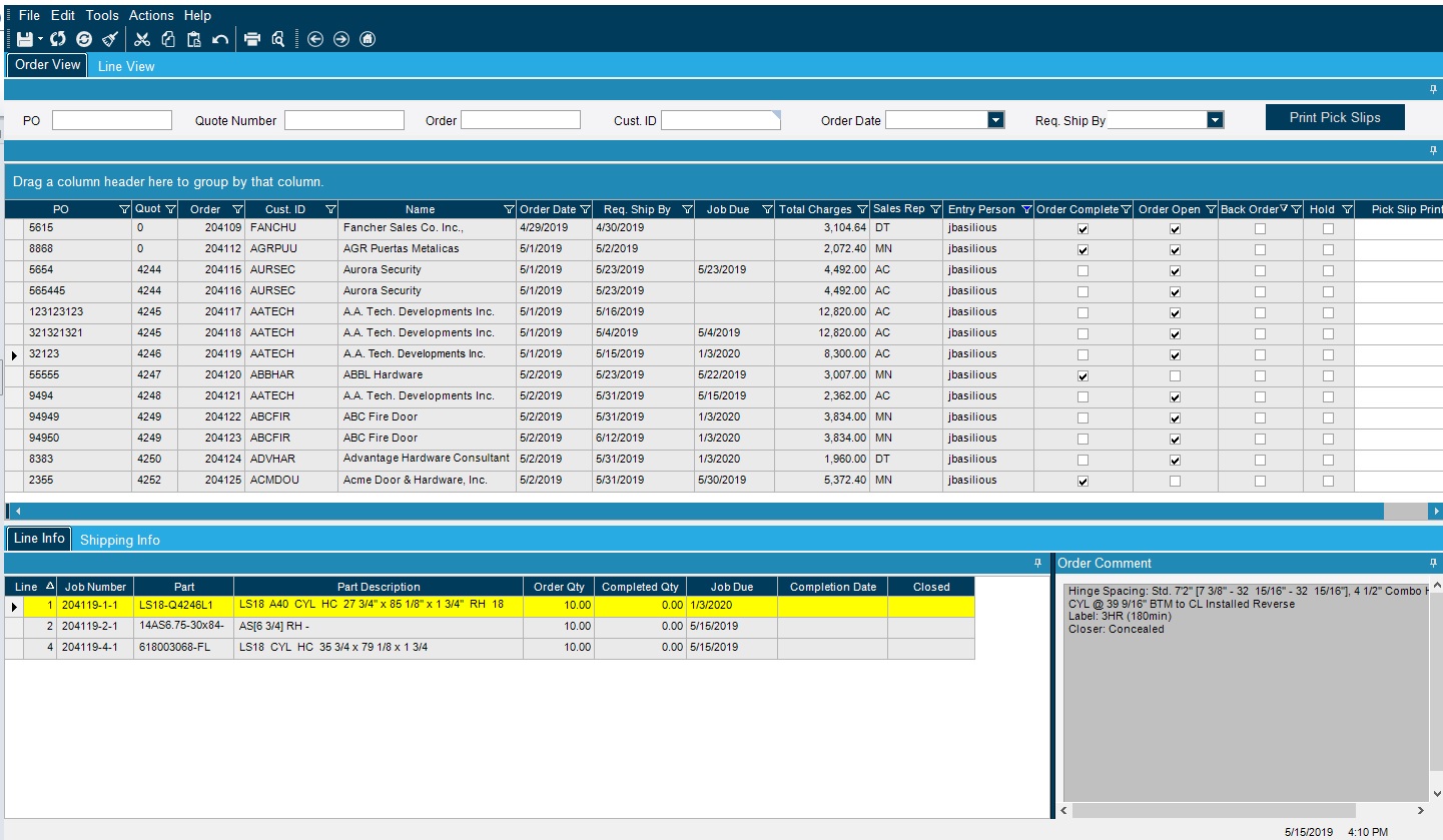

The structure is like:
Both tabs at the top are separate BAQ’s, and the two tabs at the bottom, line info and shipping info are also separate BAQ’s. i want to make the entire lower section only visible when looking at the primary Order View Tab.

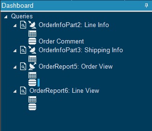

Hmmm … I’m not even sure how you got the ‘Order View’ tab and ‘Line View’ tab in the same container. Can you post a pict of the Dashboard tree (from developer mod)?

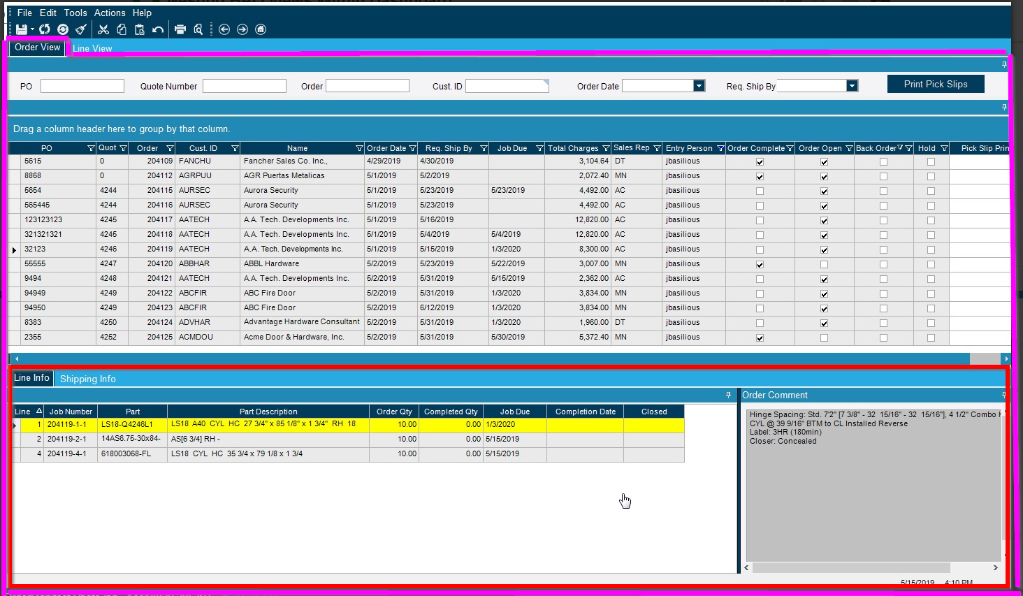

So you want tthe bottom part (outlined in red in my pict below) to pnly show when the Order View tab is slected (purple outline). And only the grid on the Line View tab to show when it is slected. I assume youd like the Line View to expand to the bottom of the window too.
OrderManifestdashboardtree
You got it, that is exactly what I’m trying to do.

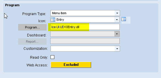

  1. Add a menu entry for a UD table form like:
  2. In developer mode, launch that menu you created (Note: the menu won’t show unitl you exit and relaunch the client, or switch users to the same user).

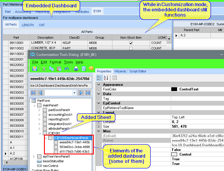

I tried to see if customizing the form that you inserted the dashboard (via Sheet Wiz), would allow elements of the dashboard to be referenced (and controlled) by the parent form. Turns out that even while in Customization mode of the parent form, the embedded dashboard still runs like normal.
