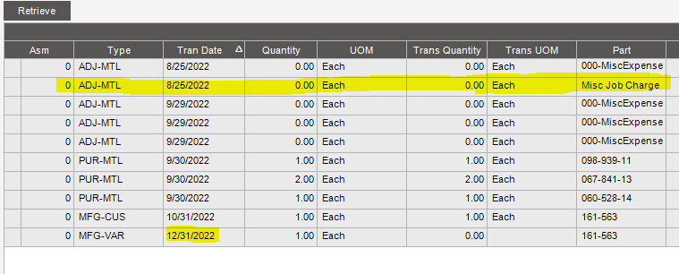

The same data that is on that report is in job tracker - Job Details > Assemblies > Transactions. Sort by Tran Date descending and look for transactions after the last MFG-STK.

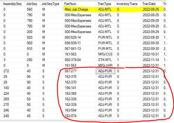

Thanks @gpayne for the thought to check here on this screen. For others - I’m not seeing the post-ship / post-close transactions on the Job Tracker screen. Found them in SSMS though.
That was incorrect, notice assemblyseq…
Job screen:
SSMS:
Are those on the same job? The MFG-VAR is 12/31/22 and the ADJ-PUR is a year later 12/31/23.
Although I can see the theory on this working. purchase direct to job $100 of materials in wip. Issue to finished goods with $100 of material cost. Vendor invoice is for $90 reducing material cost, so the amount of material on the job is now $90 minus material cost issued to finished goods $100 is -10.
Yes those screenshots are from the same job. WIP report shows -$2535 WIP on that job now, and those transactions after close add up to that amount.
