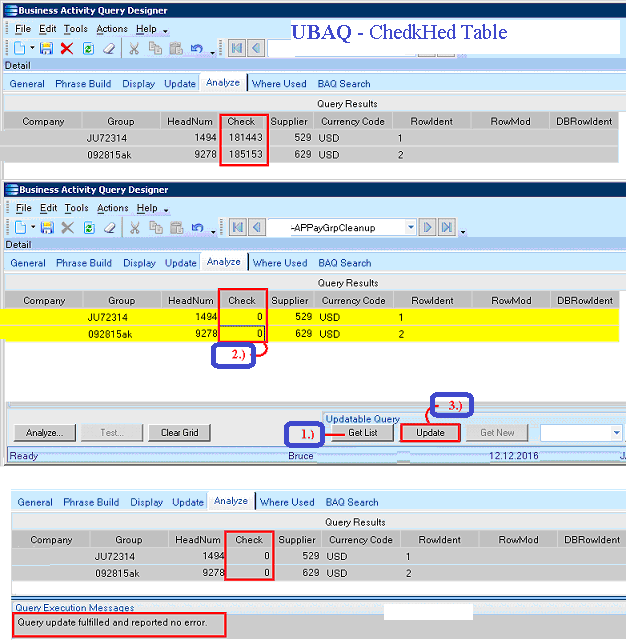

I had something similar a while back and was able to work around it with using UBAQ.
By setting the check number to zero in CheckHed… I could delete the line from the AP Group.
Not sure your situation is exactly the same so you would want to verify in Test first.
Thanks Bruce. I wrote a BAQ looking for the value that was negative thinking I could fix that, but didn’t think of changing the check number to zero. Not sure if they’ll be willing to go that route, but I will ask.
