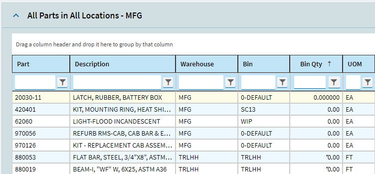

We ran out stock status report and saw several parts that are negative. After reviewing, i noticed that several of them have the Part Class Negative Action set to stop, yet they still went negative. Has anyone else had similar and knows why this is happening?
Is the net sum of inventory positive? Don’t know if this is still a thing, but you used to be able to go negative in a bin as long as the net of all the bins was positive.
Also, if you use material backflushing, that process ignores the Warn/Stop actions when going negative. Epicor will happily backflush your material negative.

I didn’t see the material as back flushed. Had to run a bag to see it as I couldn’t find it in the revision. Still getting used to kinetic screens.
Net inventory is positive. I’m guessing the only way to stop a negative from any bin is a bpm.

I don’t think you solved it.
In 10.2.4 going negative in a bin will throw the exception, even if you will still be net positive.
e: to expand, as @tsmith said backflush ignores the part class setting, and there may be other situations that I am not aware of. I don’t suppose you use kanban receipts?
