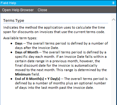

I don’t think its possible to do this out of the box. Here are the only types of AR terms codes that are built-in:

Have you tried setting the Terms Type to Monthly and then entering the Billing Day?
Then the Due Date should calculate off of the Billing Date which would be the same day each month.
Yeah, that doesn’t work for us.
Setting them up that way means we ship them everyday, but they’re shipments would only be selected for billing on the first of every month. Each month we invoiced them wouldn’t make all their invoices due on 10/1/2024.
Accounting wants them invoiced when we ship with a due date of 10/1/2024.
