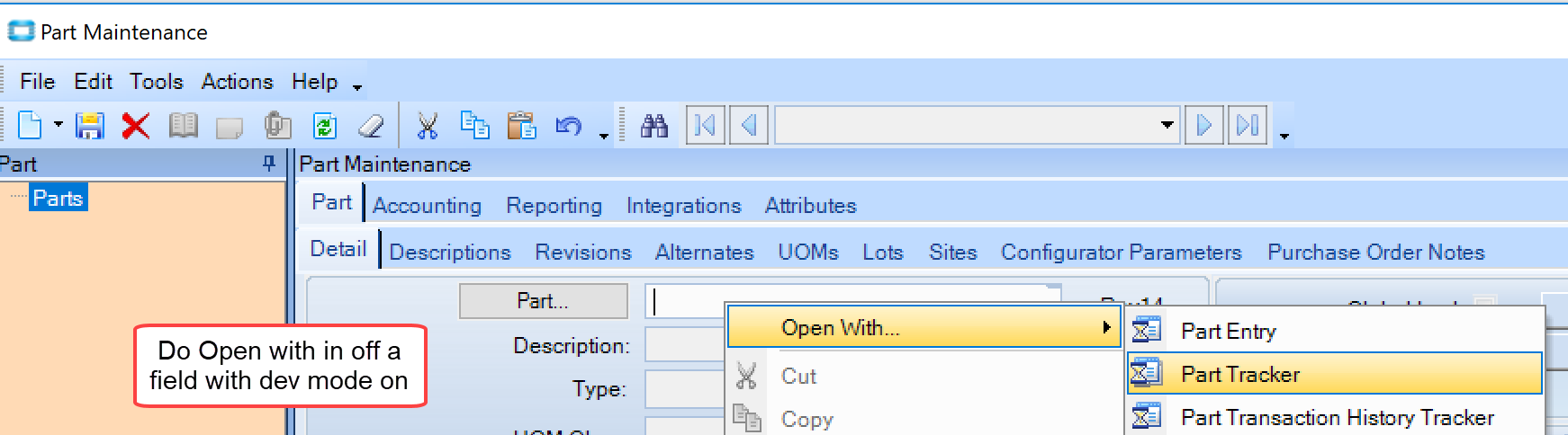

The context menu (open with) will use the menu security of one specific menu ID. If you open it while developer mode is on, a box will pop up telling you which Process ID is called. That Process ID should match the menu ID from menu maintenance, so you can verify the security used by the context menu.

  1. to get the customization and / or security to work when you open with, figure out which process is called when you open the program with the open with (alternately when in program get the process id via Help / System Info / Software Environment per 3rd screenshot below). Then in menu, one of the assigned will be called this id. Ensure that you setup security on that.

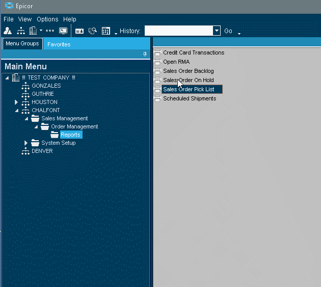

And make sure the actual menu item security is set. Just removing access to the menu’s Parent (like General Operations for Part entry) doesn’t do anything to prevent a user from using right click and “Open With…” ?
I did a test where I gave a user access to nothing more that Sales Mngmnt -> Order Mngmnt -> Reports.
All other “top level” menu were set to disallow access (but not their child menus) And was still able to get into Part Entry.
Here’s a GIF of using the Part filter field in a report, to open Part Entry.
Setting the security on the Part Entry menu item does the trick. After doing that, I get
When using the Open With…
