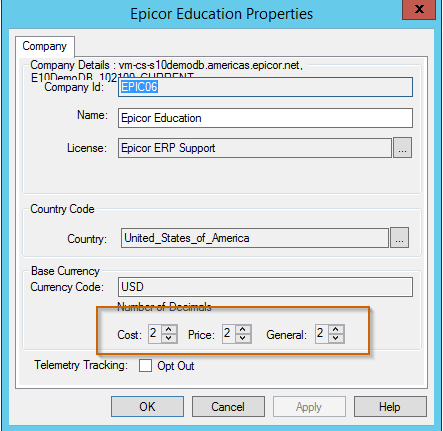

  1. Can I change the number of decimal places used by costs from 5 to 8?
  2. Would this have to be across the board? Or could it be Part or UOM specific?
  3. Would using the Cost Per (/1, /100, /1000) in PO entry help? I’d guess not, as the cost per IUM eventually needs to be calculated and stored to 8 decimal places.
There is a data fix that our application support team can request on your behalf that can change the number of decimals for cost, price and/or general from X to Y–but, it would be across the board and not specific to an individual part/UOM.
That said, perhaps there is a different way within the application to handle this condition so I defer to others more knowledgable.
