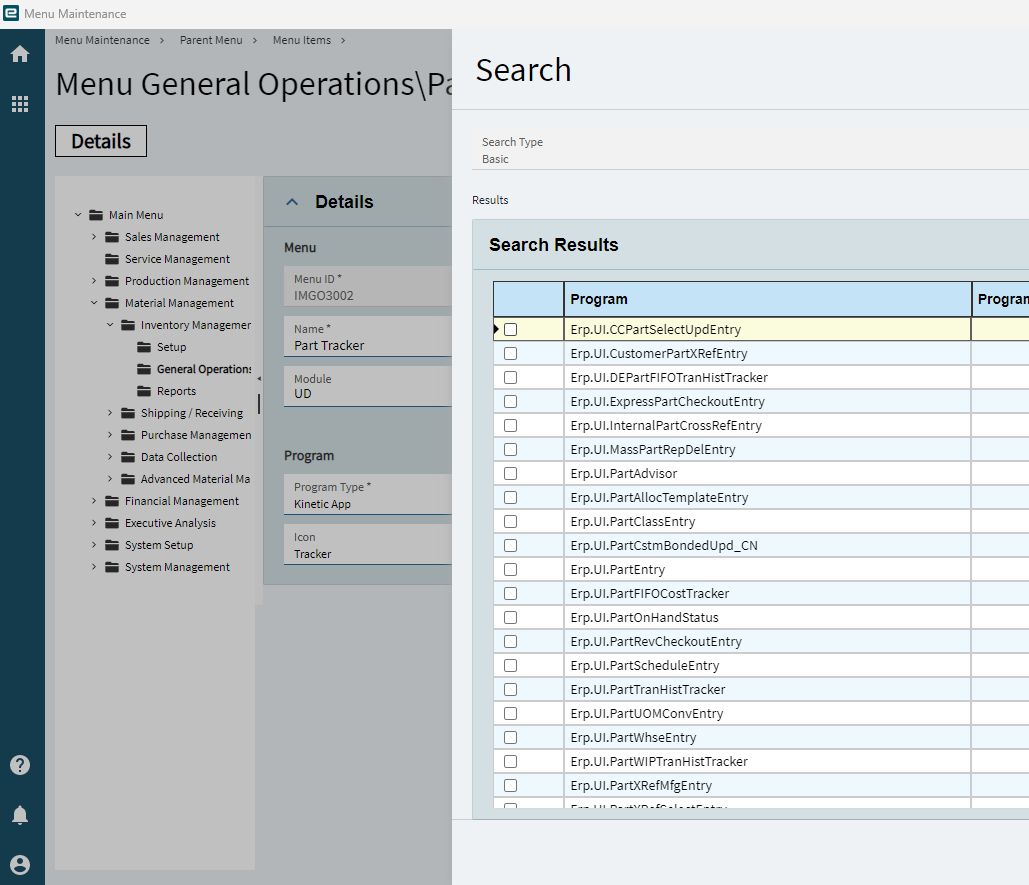

I Created a customization for PartTracker in App Studio, however, when switching screen to “Kinetic App” in Menu Maintenance, the Program drop-down does not have a .dll for PartTracker. If I set it to ‘Erp.UI.PartEntry’ I can see and add my PartTracker Customization, however, it turns PartTracker into PartEntry where a user with privelages can change a Part’s data. Not good.
I ran PartTracker in Browser to trace program, but only find "Erp.BO.PartSvc’ which is not really what I need.
The default Menu Item’s program is ‘Erp.UI.PartTracker.dll’ however, none exists for Kinetic App program type. Anyone able to modify the PartTracker in Kinetic?

Same using that tool. The problem is that there is not a “Program” as they call it, for PartTracker in the list. Maybe not yet added to the Kinetic sUX interface.
What if you use the part entry dll but check the ready only box? Disclaimer - I haven’t tried it myself.
Worked like a charm… thanks for pointing out that checkbox. Both in Classic and Kinetic sUX work.
