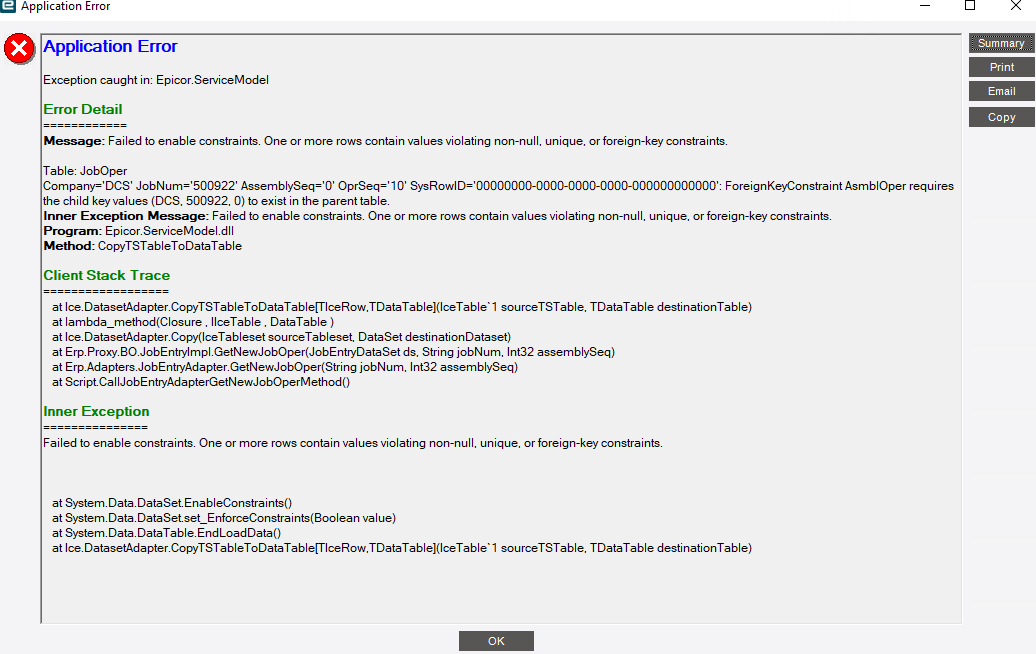

But when I create a new job, add a part and product group, save, then hit the button, I get this error message:
The summary is : "Failed to enable constraints. One or more rows contain values violating non-null, unique, or foreign-key constraints.
Table: JobOper
Company=‘DCS’ JobNum=‘500925’ AssemblySeq=‘0’ OprSeq=‘10’ SysRowID=‘00000000-0000-0000-0000-000000000000’: ForeignKeyConstraint AsmblOper requires the child key values (DCS, 500925, 0) to exist in the parent table."
What is this referring to? I’ve tried BPMs (pre and post) on the GetNewJobOper method to set those fields on the JobHead, JobOper, and JobAsmbl tables to no avail. What else should I do?

The job assembly 0 do not seem to exist. You cannot create a JobOper or a JobMtl if the JobAsmbl does not exist. Can you look in the database to see if the JobAsmbl exist for the job you are using?
If it didn’t exist, how would I add it or create it? And would that not be handled already by the GetNewJobOper method?
I revise your code, and you are declaring a new adapter, so the job and the assembly are not in the dataset of the adapter.
So you should do a GetByID to retrieve the job info before adding your operation.
Like that:
adapterJobEntry.GetByID(jobNum);
adapterJobEntry.GetNewJobOper(jobNum, assemblySeq);
But declaring a new adapter and having to retrieve the data already there is not the best ways.
You should simply call the existing method in the transaction, like this:
private void btnAddNewOp_Click(object sender, System.EventArgs args)
oTrans.GetNewJobOper();
Many thanks, @Louque77 …this simple adjustment helped me clear a major hurdle!
