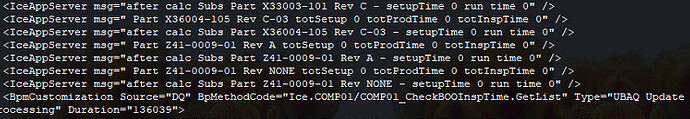

Event View is the Windows Event Viewer on the App server. Epicor has there own node.
You can also see them in the appserver log which shows the whole run and not one at a time.
Ice.Diagnostics.Log.WriteEntry($"In calc Subs - Mtl Part is now {PartMtl.MtlPartNum}");
Thank you for all your help. I don’t see anything in the Event Viewer except the errors I got yesterday while trying to make another thing work :slight_smile:
