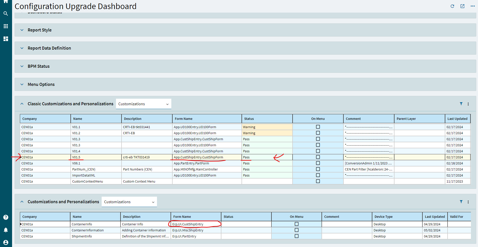

I’ve successfully run the Configuration Upgrade Dashboard, and the customization in the Classic UX works perfectly.
However, I’m struggling to migrate these customizations to the Kinetic UX. I even have all the .vb codes used in the Classic UX.
I attempted to create a new layer in AppStudio, but it is clear that the .vb code isn’t activated as expected. Could anyone provide some insights or steps that I might be missing?

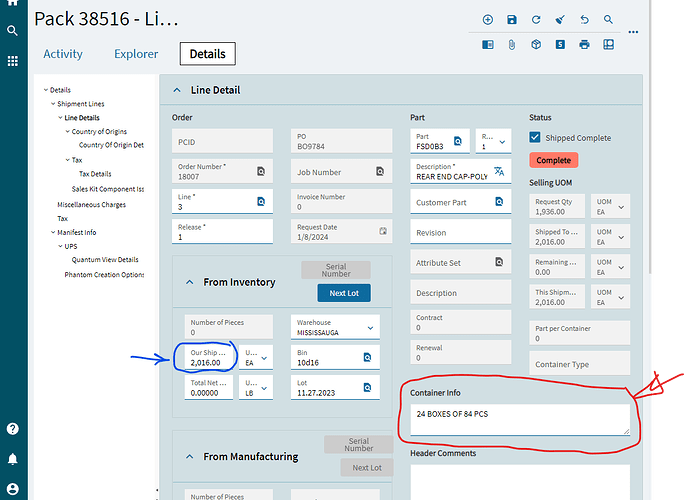

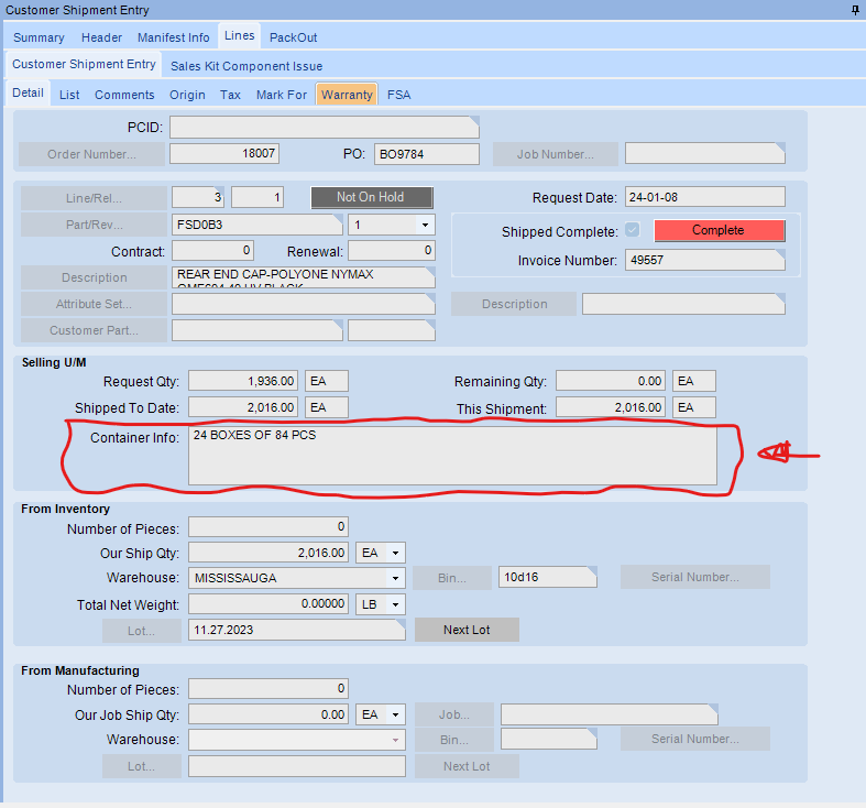

I started this painful path and I used the Classic UX as a reference.
See below the Classic UX, where in Red is the customization applied. The real scenario this process was done by another person way back in time.
I am trying to do some reverse engineering. (It is painful :tired_face:
I have created the Kinetic UX with a Layer (marked in Red) see below:
So far I noticed I am missing the creation of the proper Event to be activated from any modification in the field “Our Shipment” (In Blue).
I point the EpiBinding to the right field, but it is not updating after updating the field marked in Blue.
Again, I need some guidance, since the tutorials read so far are not enough for this.
