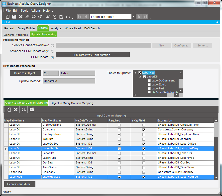

On attached file, I did not want to include the LaborHed table on this uBAQ, so I simply took the LaborHedSeq from LaborDtl.
If you scroll down, you should see those rows with nothing in the Expression field. Copy the info in the related field from the other table. Note, you need to have a related field displayed on the query to be able to copy the ttResult expression, so you’ll need to add JobOpDtl.AssemblySeq to your query at the very least.

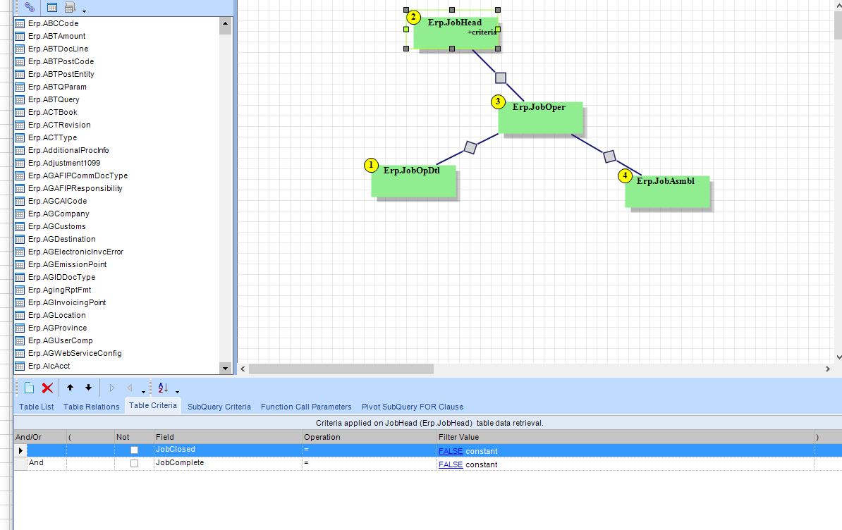

So after working with Epicor support, their agent Juan helped me get a working Ubaq and dashboard.
for anyone who finds themselves here looking for a solution i needed to have my baq setup a little differently than i first laid it out (see first picture for proper layout). I also needed to have multi-row update turned on.
