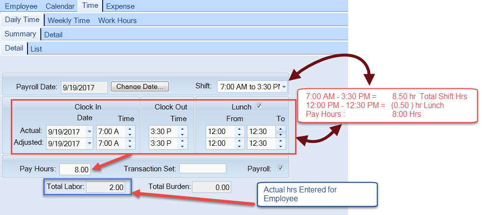

Not an expert in SQL but i believe the “Pay Hrs” are not actual hrs but estimated pulled in from shift maintenance. Ex. if employees as scheduled to work 8 hrs per day, then the “Pay Hours” would pull in as 8 hrs but the actual hrs (labordtl.laborhrs) could be different than the normal “scheduled” hrs (overtime, or not working the 8 hr shift) for each employee.
LaborDtl.LaborHrs = actual hrs reported
LaborHed.PayHours = hrs calculated based on normal shift hrs : Job managment > Setup > Shift. (Shift hrs - Lunch hrs = Pay Hours)
I believe you will need to use an InnerSubQuery because this calculation:
will multiply the pay hours by however many LaborDtl records exist for each LaborHed transaction.

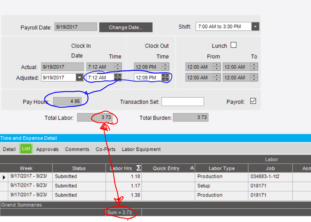

I’m pretty sure LaborHed.PayHours is the actual hours employee will be paid for, linked to Time and Expense Entry > Time > Daily Time > Summary > Detail.

Maybe we have different setups. I just tested it out and my payhours come from Shift Maintenance. Now, i do manually change the pay Hours to match “Total Labor” hrs once i am done entering all the labor hrs for each employee to make sure both totals match. The “Pay Hours” could be over ridden where as “Total labor” hrs come from labor details and can only be changed by updating the labor entry details.
The Pay Hour (LaborHed.PayHours) are the difference between the Clock In
time and the Clock Out time, for the Labor Header (the amount of hours they
are paid for). The Total Labor are the sum of any detail records in the
Labor Header (LaborDtl.LaborHrs).

Al,
If you change the shift field it will automatically pull in the clock in/clock out times. But if you use MES for actual times, the pay hours will come from actual time worked (ClockOutTime - ClockInTime) - Lunch (if applicable)
