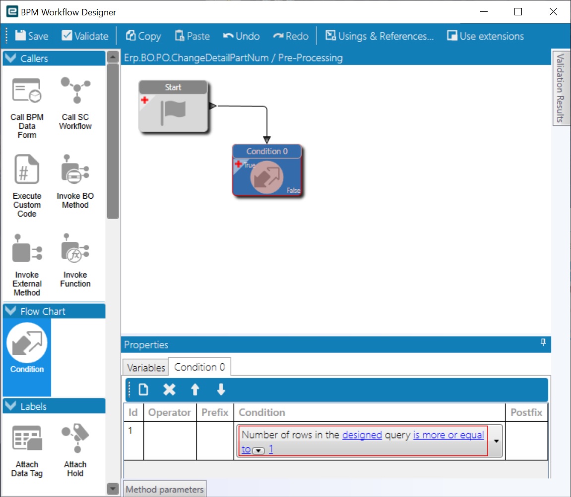

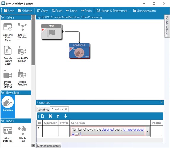

You should be able to do this without custom code, by using the condition widget with the “number of rows in the designed query is more or equal to 1”. Build the query, link to the part table and the vendor table and have a condition in the query where Vendor.QAClassNum = Part.UserInteger2. If they’re equal, it will return one row and the condition will be true. If they’re not equal, then it will return zero rows and the condition will be false.
Seems using ‘Synchronously Execute Custom Code’ action, I see where I can add the Variable names and type. Still need to link them or populate from Vendor_UD and Part Tables. working on it…
On that method, the “Number of rows in the Designed query is more or equal to 1” is not available as a choice condition. That is why I was using the “The specified expression is valid” or “The custom code condition is valid” conditions on the Condition widget. If I could do it with a BAQ that would be great as well. Still poking around…

Yes, I opened it in Classic and that choice is there…ughhh
Thanks for the screenshot, it tipped me that you are using the Classic shell, and I was using Kinetic.
