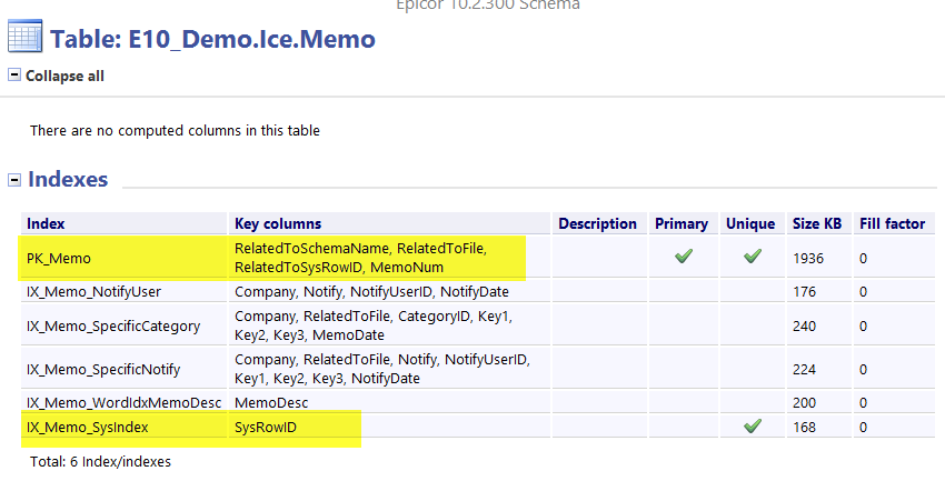

Thanks for your input Calvin. I will do it on the keys too and see if I get a different result, it’s just the memo table has so many “key” fields… where do I stop, what do I include?
For example, is “relatedtoschema” also needed in the join? I would probably be able to tell from data dictionary, but I’ll ask it here too.
Well, lots to choose from. Looks like the following fields would suffice.
RelatedToSchemaName, RelatedToFile, RelatedToSysRowID, MemoNum
Or go with the last one :wink:
