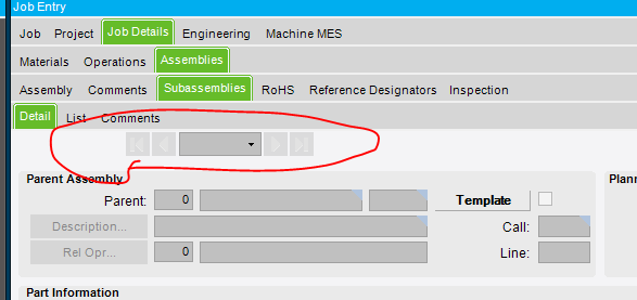

Is it possible to navigate to a subassembly in a job using only the Assembly Sequence number?
Often we know the Job #, Assembly Seq, and Mtl Seq of a particular job material. I want to edit this material. If it is buried in a subassembly of a multi-level Job BOM, it is very difficult to quickly navigate to the subassembly without knowing the assembly Part Number and using the Find Assembly Part command in the Job Tree context menu.
