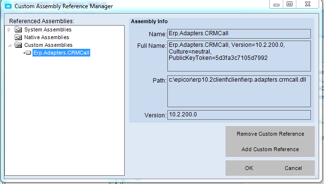

I am attempting to duplicate and modify the Salesperson Workbench as a new Dashboard. I added a new Tracker View under CRM Calls that should have a button on the tracker to create a new CRM Call or open an existing one by calling Erp.UI.CRMCallEntry.dll. I copied all the code, including all the ‘usings’, from the original Tracker View that included this functionality, then updated the reference to the DashboardViewPanel by changing the DBTVP ID. The new Tracker View originally worked, but once I deleted the original one, I get this error during compilation.
--------compile errors------------
Error: CS0234 - line 36 (35) - The type or namespace name ‘UI’ does not exist in the namespace ‘Erp’ (are you missing an assembly reference?)

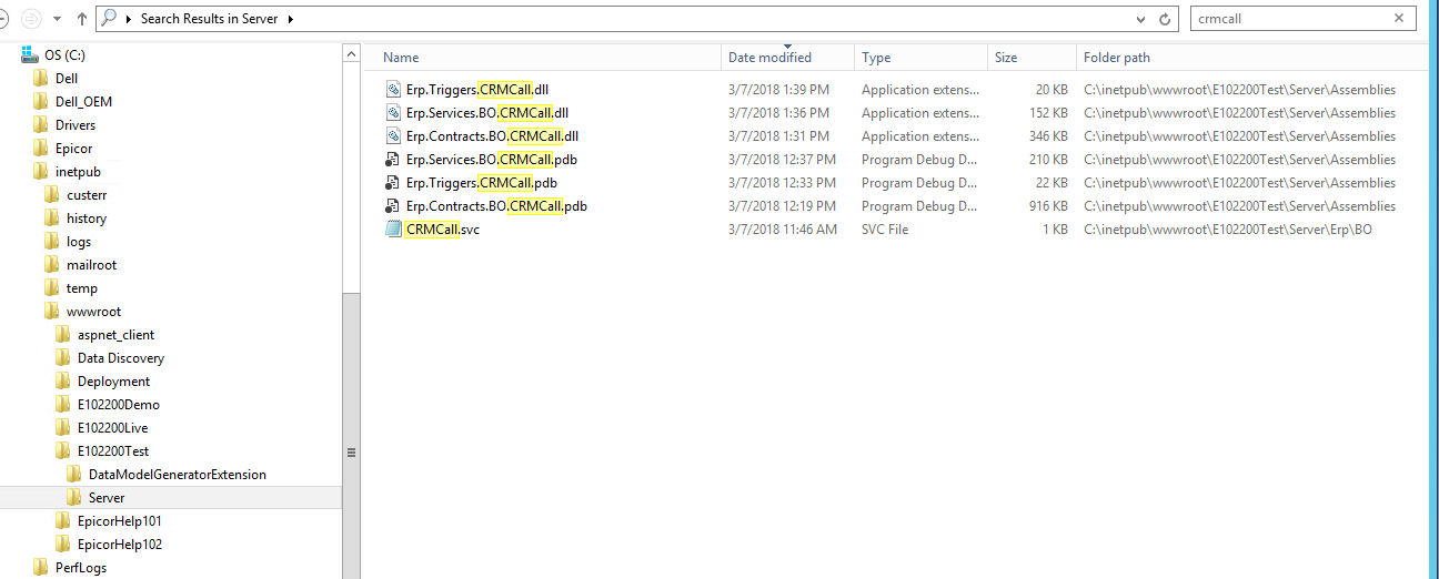

The file Erp.UI.CRMCallentry.dll does exist in the client directory.
But the file doesn’t exist in the IIS directory:
I am pretty new to customizations, so the acronym I just learned ELI5 is certainly appropriate for me (Explain Like I’m 5).
