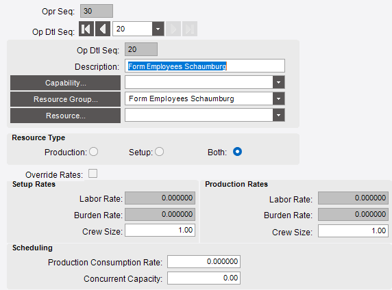

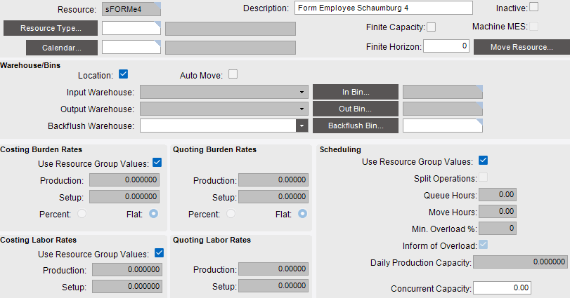

For OpDtl 20 (Resource Group “Form Employees Schaumburg”) there are 6 ‘Resources’, which are also set to use the values from the Resource Group (which has everything set to 0 anyway, so I am not sure what this is doing). All of the Resources are basically blank, except for the Resource Description and Resource Name, as shown here:

What is a reason for multiple Resources (one for the Machine, one for employees) in an Operation? I would think that setting the operation up to use 2 employees would be the proper way to do things, but again maybe things are different when there are multiple employees running a single machine when compared to a single employee running multiple machines?
Having multiple resources on an operation record means that the Scheduling Engine has to find capacity on BOTH resources SIMULTANEOUSLY in order to fit that operation into the schedule. If the machine is available THIS afternoon but the operator isn’t, the engine won’t schedule it for that time block.
Each OpDtl record serves as a capacity restraint to scheduling.

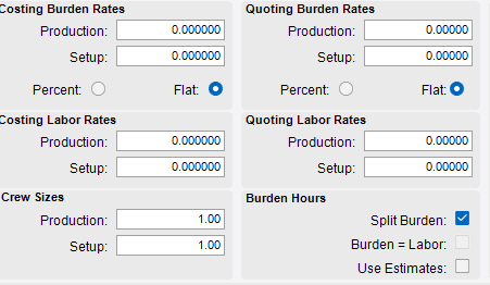

I am reading this as the “Crew Size” under Resource / Resource Group is strictly for costing, and not for scheduling. Is that accurate? If so, it would make sense as to why there is the Employee Resource Group as well.
@jhecker You are correct. The crew size is for costing, not scheduling. I would, however, zero out the crew size on the machine and add the correct crew size to the employee resource. That way it is clearer for costing. Right now, it’s going to cost a crew size of 4 on the machine and a crew size of 1 on the employee, so you are over costing the labor. By having a separate resource for labor, the scheduling engine will schedule the machine only when an employee is available.
There is a little more to it than that because that is coming from a 1000-foot level, not a detail level.
How would that be over costing the labor? I realize that the wording of my question sounds rude, but I am not meaning it to be, I am genuinely asking how that works. That operation does require a Crew Size of 4. How does having it on the machine differ than if it were on the employee resource group?
It doesn’t really differ on what resource it’s on, just that you shouldn’t have crew size noted on both. You have a crew size of 4 on the machine resource and a crew size of 1 on the person resource. That will add together to be a crew size of 5 total, not 4. This will affect estimated costs.
If there is a people resource and a machine resource on the same operation, I usually use the people resource for the crew size.
Also, if you have standard costing and do a cost roll on the part, the labor will be for 5 people not 4 (same as above).
One other thing is that you have a crew size of 4 on the setup for the machine resource and a crew size of 1 for the people resource. How many people does it take to do the setup for this operation? If it only takes 1 or 2, make sure you reduce these to the correct number. I would put those on the people resource as well.

Looking at how they have the “People” resource configured I noticed that the rates are all $0.00
On the Machine side, there are values in there. So, if they were to put all 4 people on the “People” resource, it would throw off the costing quite a bit, as the system thinks that our people come at no charge. So we would either need to fix the rates in the resource or have the crew be on the Machine side of things.

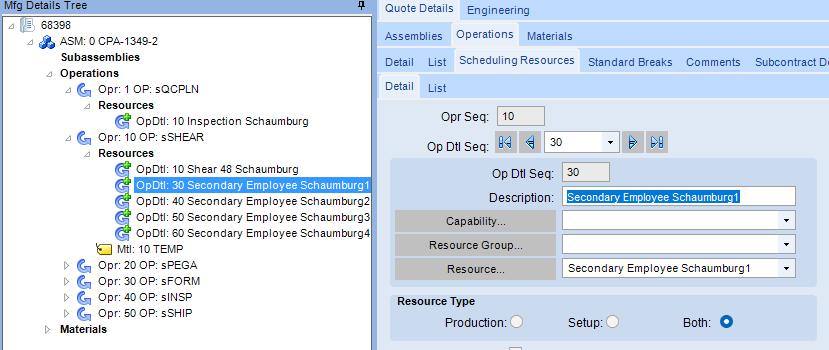

It would look to the second resource to schedule a person resource. Scheduling uses resources, not crew size to schedule. It’s not easy to schedule people resources in the system. Keep the people resources as generic as possible, otherwise you will end up having to maintain calendars for your people resources. If this operation uses 4 employees and you want to schedule 4 employees, then you wouldn’t list the employee resource group but would list 4 employee resources from that group along with the machine for that operation.
For costing purposes only, you can leave the machine with 4 as a crew size so it will cost properly (that’s where the labor rates are, correct?)
You mean something like this?
Yes, that is exactly what I mean.
