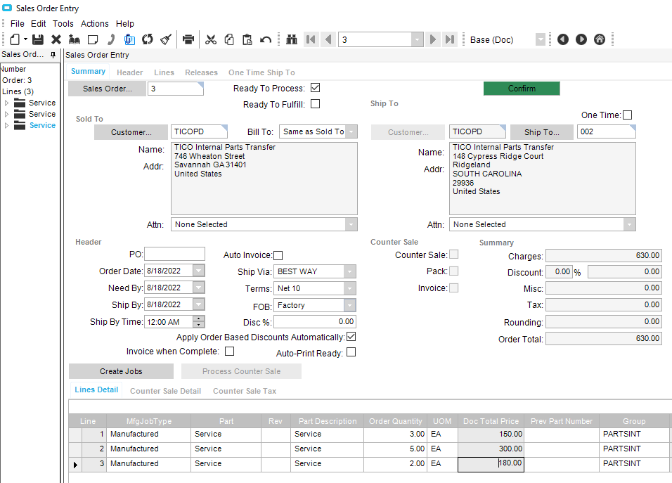

So the idea sounds like this:
  • Order 10001
    • Line 1 - a stock part
    • Line 2 - another stock part
    • Line 3 - “Service” = 3 hrs @ day rate ($50)
    • Line 4 - “Service” = 5 hrs @ evening rate ($60)
    • Line 5 - “Service” = 2 hrs @ weekend rate ($90)

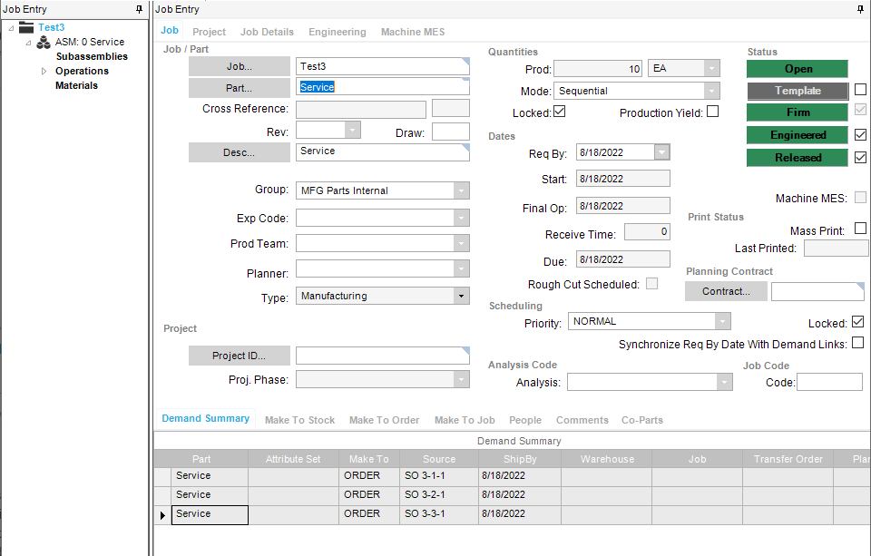

  • And lines 3-5 are tied to a single job if possible?
Eek, I don’t know.
I get it, desire 1 is that the techs have a single job number to have to deal with, and desire 2 is that the customer see a breakdown of the costs. And desire 3 is to tie each line to the job. And all of those things work fine.

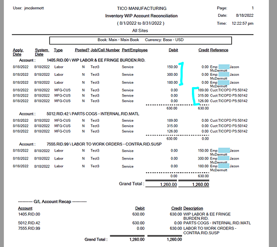

But I think the issue is tying the real costs to their respective lines, right?

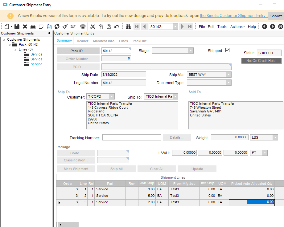

I did this test and as I expected, the shipped costs are simply total costs divided by fraction of production qty. (3/10, 5/10 and 2/10, respectively.)

Would doing 3 lines on the Sales Order for the hours (Daily Rate Hrs, Evening Rate Hrs and Weekend Rate Hours) work?

Yes, but I thouhgt that would mean you need to create 3 jobs. One for each line?

So basically it is possible to create one job and connect it to individual sales order lines. We can then see the hours worked for each line, but the costs will be split based on the average rate on COS level.
Mark,
Yes, the costs would be accurate by the overall order by not by the line if you used one job from a financial standpoint. But you could handle the customer issue just by a small customization to your sales order (showing cost / line).
