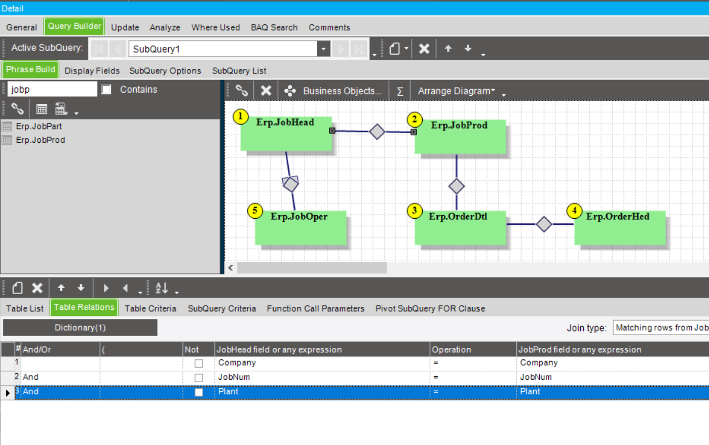

It sounds like there is a table join in your Query Builder that needs an additional Table Relations line added to link the Site/Plant for the 2 tables. Can you share an image of your Phrase Build?
(Table Relation JobHead.Plant = JobProd.Plant highlighted below)

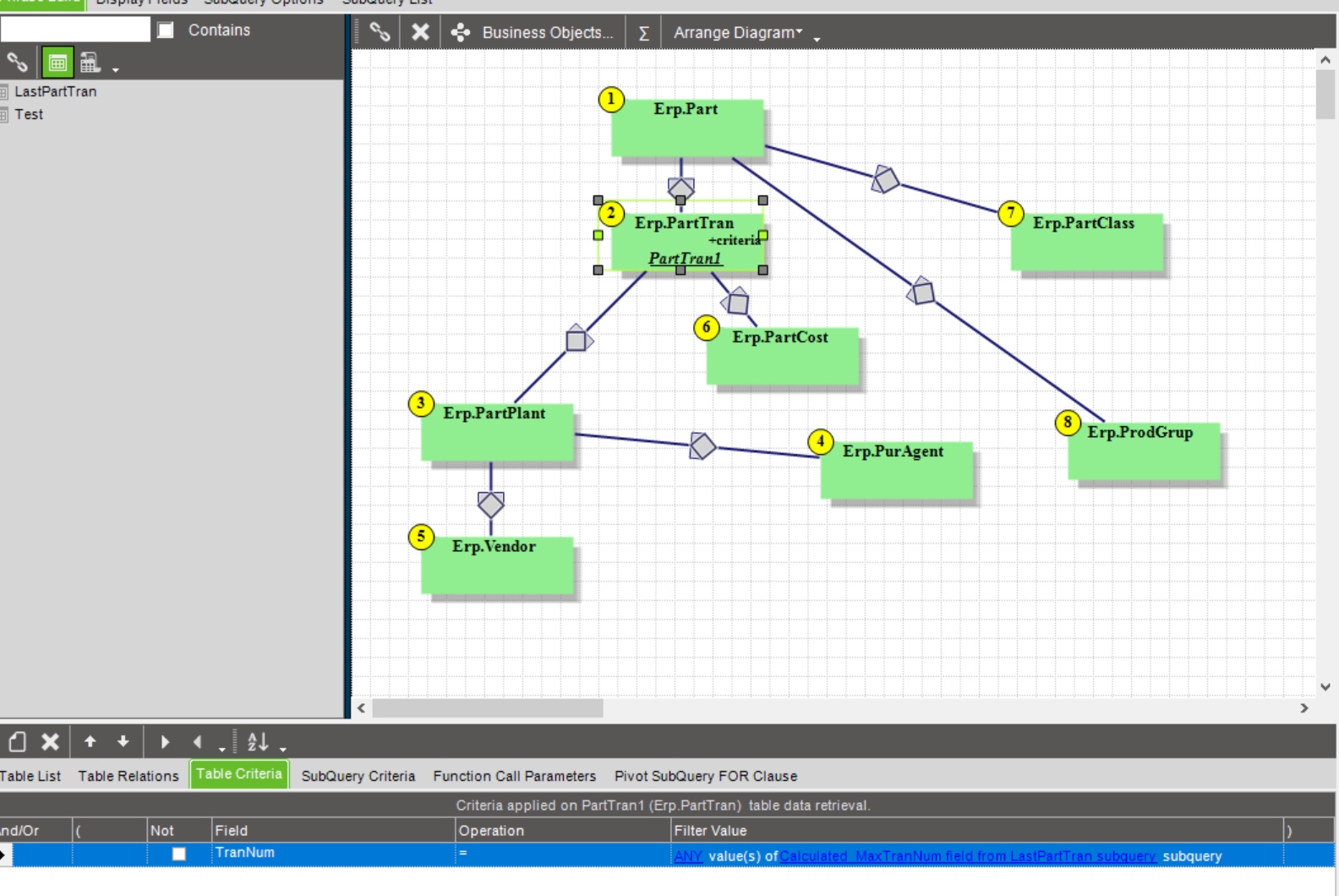

Okay I think I got it. There’s probably an easier way to do this, but it should do the trick.

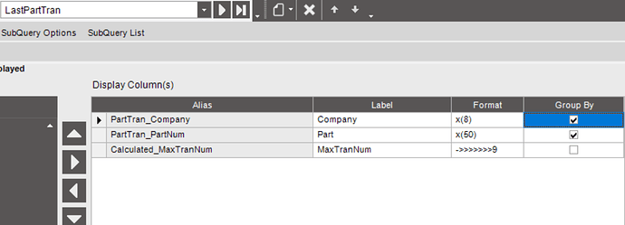

I created a subquery with just the PartTran table, with the fields below. The calculated field is just MAX(PartTran.TranNum).

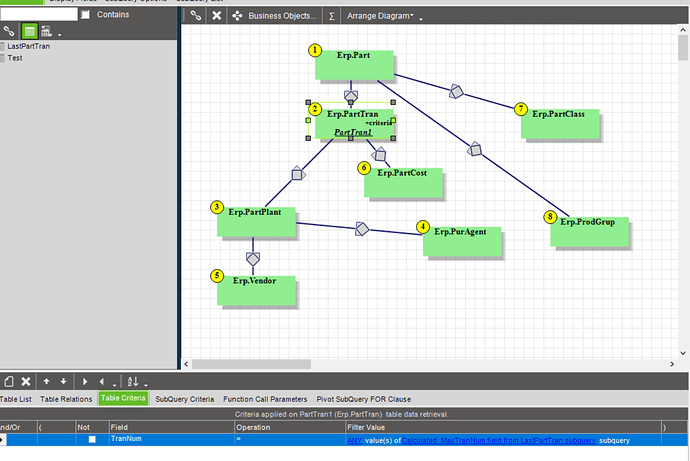

Then in the main query, instead of connecting part directly to PartPlant and PartCost, Part is joined to the PartTran table, and PartCost / PartPlant are left-joined through that.
On the PartTran table, I added the criteria TranNum = <selected> value(s) of the <specified> subquery using ANY value and the Calculated_MaxTranNum field on the subquery.

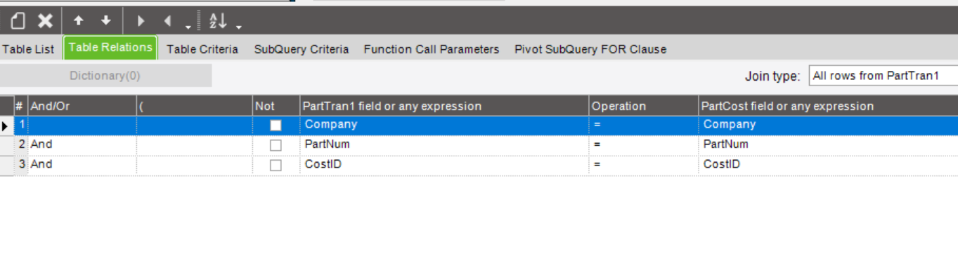

I also added the CostID to the relation on the PartTran - PartCost join:
