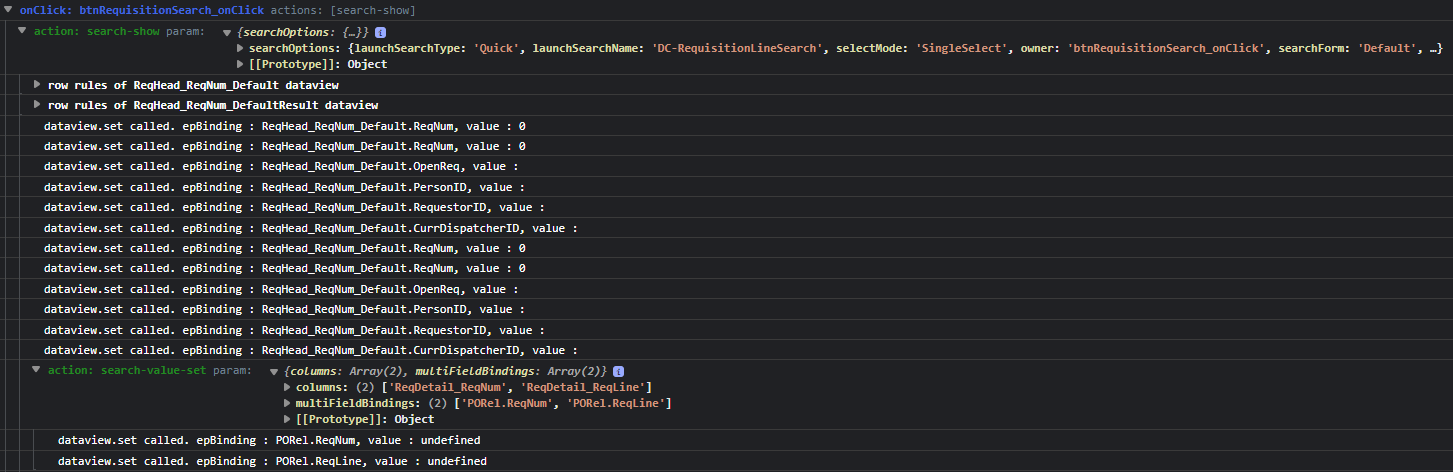

Dev tools show this:
Am I missing anything, or have something configured incorrectly in my setup?

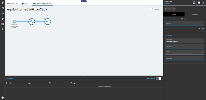

Ope, I got it.
Instead of using search-value-set, use a row-update and use the ErpSearchResults dataview for the value binding.
"{ErpSearchResults.POHeader_OrderDate}"

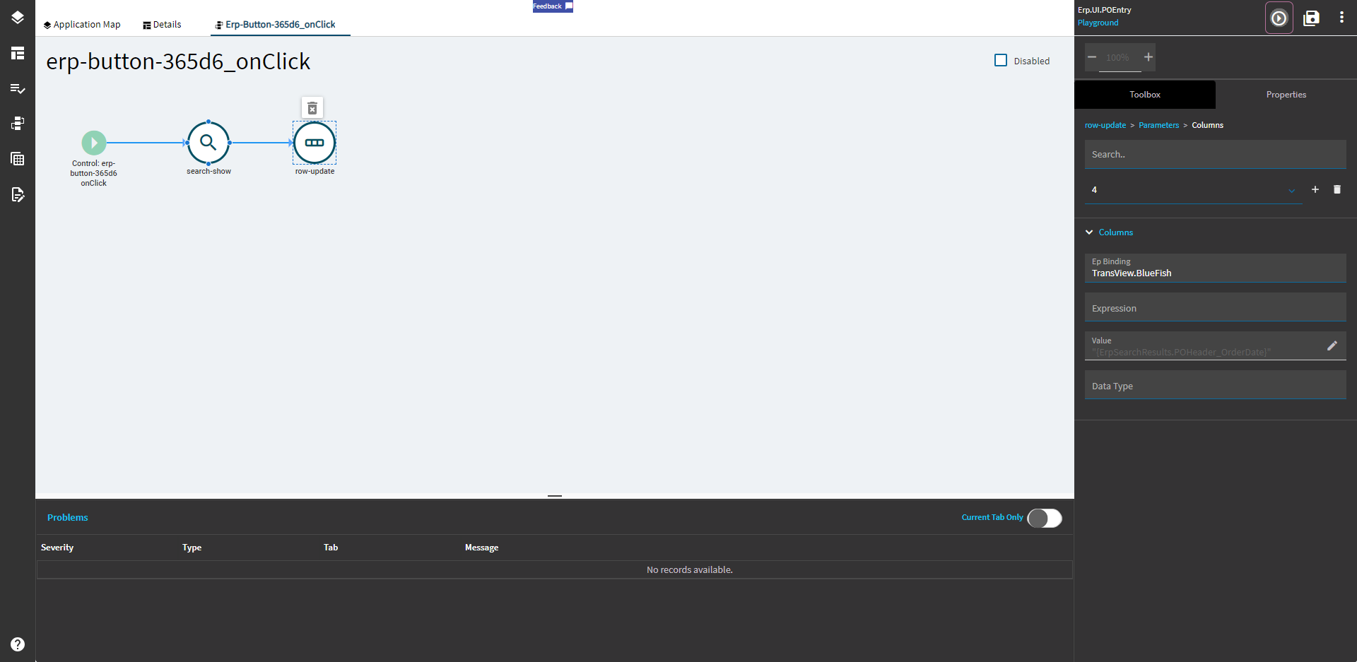

Might be able to use the dataview-condition dataview-filter-set to do a lookup of the key field in the searchResult to the ErpSearchResults (ew).
Here ya go.
