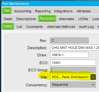

I want to clarify what you see and share what I’m seeing. Rather than “part A” and “site B,” I’ll give you some real numbers.
  • Small parts are manufactured in the MFG site
  • Those parts are sold from the PDC site
  • But for testing, let’s set
    • Part 10918 (rev E) to be made in MFG, yet
    • Component 10918-1 rev C made in PDC (in MFG, type is Transfer from PDC)
    • Component 10918-2 rev C made in PDC but not assigned to site PDC
    • Component 10918-3 (rev A) made in PDC but not assigned to site MFG
    • All parts are qty-bearing and not non-stock
    • MOM for first two components use MFG ops yet revision is assigned to PDC
    • MOM for first last component uses PDC op with a PDC revision

Right, I probably would get a suggestion if I was playing by the rules.
What I did was just take normal old revision C (created in MFG with MFG ops) and simply change its site in Part Entry. Well it sure lets you do that, but MRP can’t process a PDC revision with MFG ops in it.
I outsmarted the system! But no.
