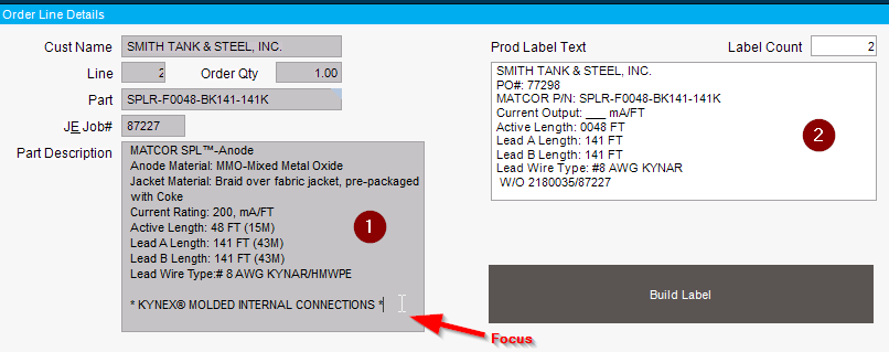

When the textbox does not have focus, the text appears fine. In the following, I clicked in the Read Only field of the Part Description (1), and the Prod Label text box(2) looks fine.
If I click in the Text box to make edits, the text appears to lose the new line characters and looks like:

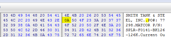

If I copy the text (when it looks like the 2nd pict above), and view with a Clipboard viewer, it shows the LF (0x0A) charcter is in the text.
If I place the cursor in the Prod Label Text box and hit the Enter key on my keyboard, then copy the text, the clipboard viewer shows a CR(0x0D) and a LF(0x0A) are inserted - instead of just a LF(0x0A).
