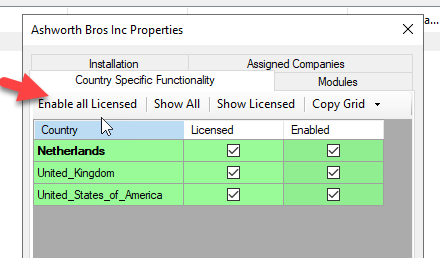

One more idea - Go to the admin console and click on the Enable All Licensed button. Having the license and applying the license are two different things. Every time I make a license change I go through this ritual.
