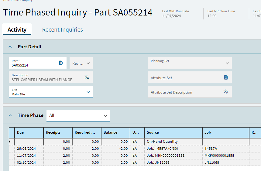

For the below part, MRP has suggested a job, due 11th July. There is already an existing job (JN11068) but its due date is 2nd Oct. However, if check the job in Job Entry, its ‘required date’ is 10th June and the job has been started.

Based on time phase, JN11068 will not be available until October 2, 2024 the demand for the part is June 26, 2024 hence the reason for the MRP job.
The time phase picture doesn’t answer the question what the demand links are for the jobs.

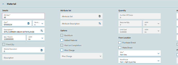

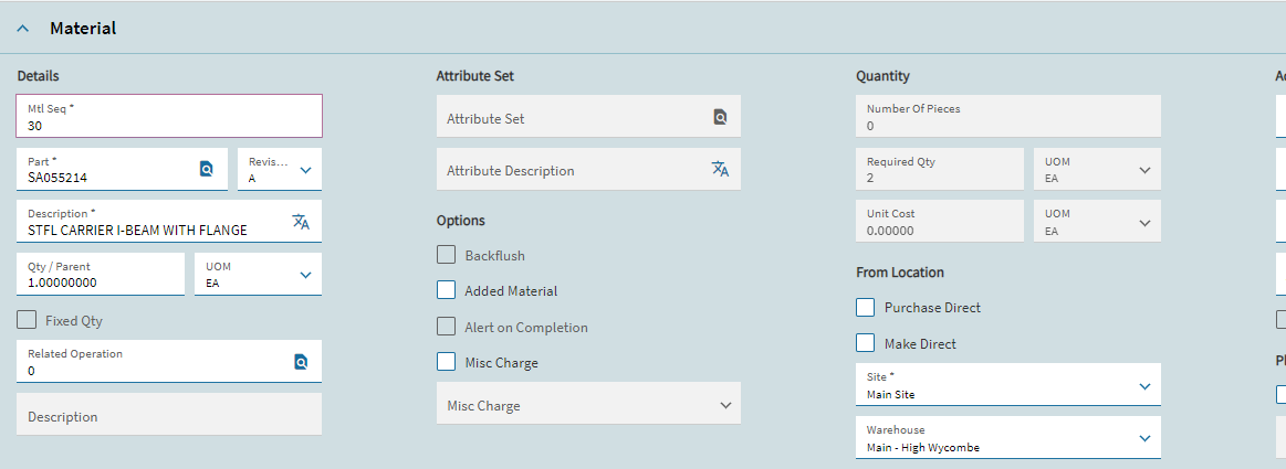

For Job T4587A - is the material link make direct?

On job T4587A, the material SA055214 is not listed as ‘Make Direct’.

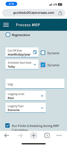

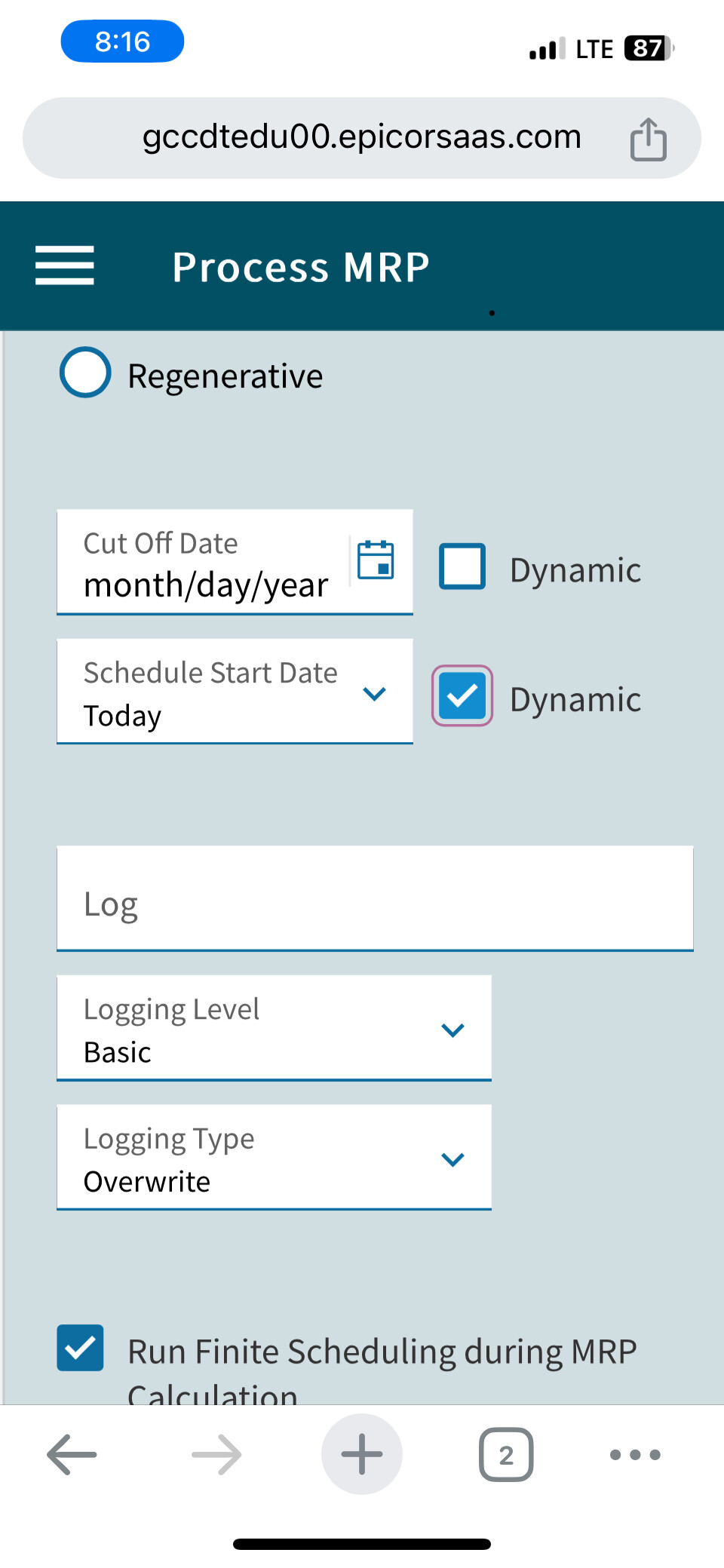

What is your cutoff date when processing MRP?
Is your start date today?
The Schedule Start Date is today and the Cut Off Date is left blank.
