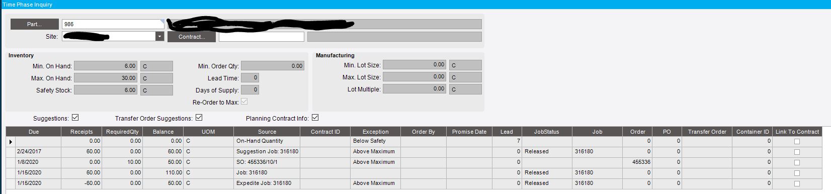

Can you share a screenshot of timephase against the part?
Hi William,
That 2017 job due date to fulfill your urgent demand (SS) doesn’t look too good to me. Do you have Dynamic checked on your Schedule start date for your submitted MRP process?

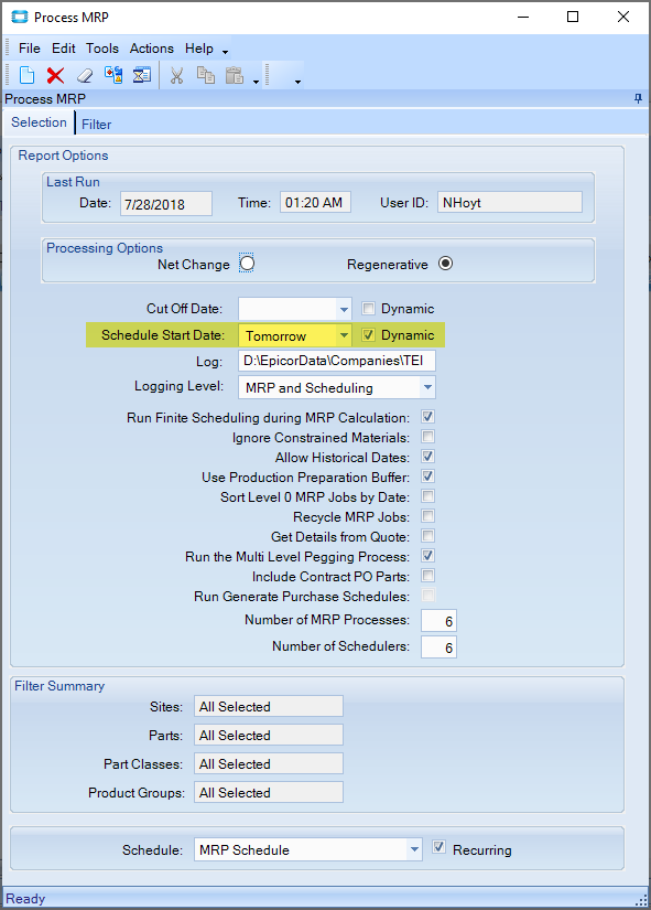

I recommend it or your urgent planning needs (i.e., fulfill SS) will all get date input here or an old submitted to scheduler date. Screenshots speak a thousand volumes. Want to show us your MRP submit dialog settings?
Just noticed the date on the MRP was for 2016… :roll_eyes: :roll_eyes: So, i changed that and it now its working.

If you can’t login as manager but have admin privs in db, then I think you can select the process MRP scheduled task under system monitor (view all people’s tasks via actions “display all Tasks”), delete the row, then you go to process MRP dialog under prod folder and open it and resubmit it. See my screenshot above on my MRP dialog that shows at bottom that it’s submitted to “MRP Schedule” and clicked as recurring.
