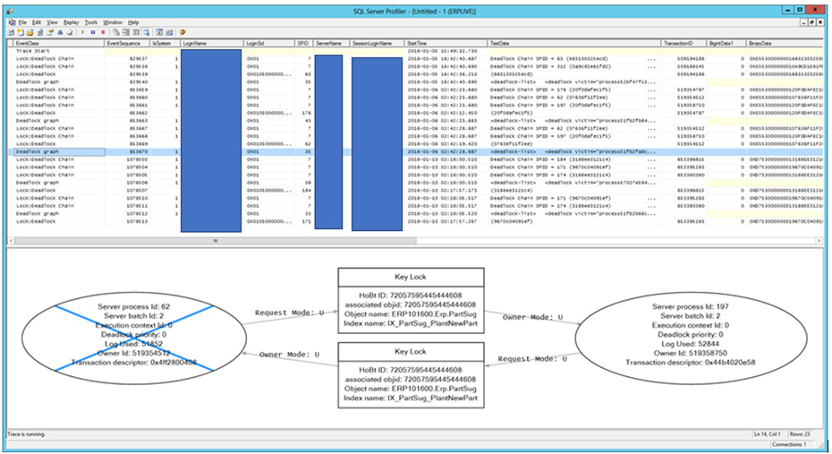

Has anyone come across occasional deadlock Issues when running MRP? Epicor can’t help much besides running the deadlock tracer 24/7 and collecting deadlocks like rain-water.
I want to know if this should be of any concern of it is normal to see this during a Verbose Logging - 2 Processors and 2 Threads MRP Run.
Doesn’t happen always; its occasional. .
Typical Errors:
An error occurred while reading from the store provider’s data reader.
Transaction (Process ID 275) was deadlocked on lock resources with another process and has been chosen as the deadlock victim. Rerun the transaction.

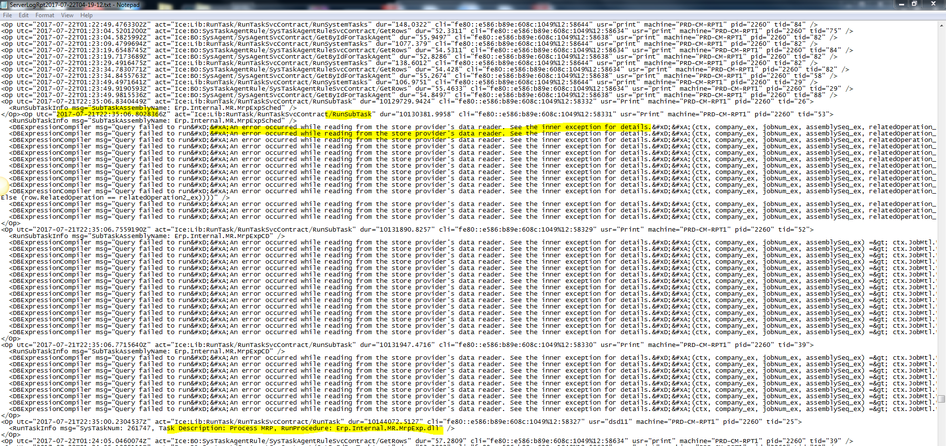

11:58:58 System.Data.EntityCommandExecutionException: An error occurred while reading from the store provider’s data reader. See the inner exception for details. —> System.Data.SqlClient.SqlException: Transaction (Process ID 275) was deadlocked on lock resources with another process and has been chosen as the deadlock victim. Rerun the transaction.
