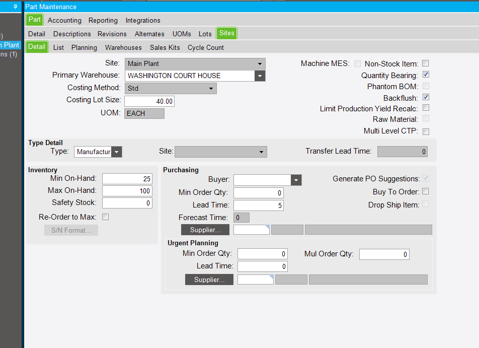

Matt - I’m attaching a screen shot - it is not checked. Bryan - when we looked at the job source, it showed the job it was linking to rather than an order.
Using time phased inquiry, can you look at the current inventory level in this plant at the time the job is scheduled to complete? While I don’t have first-hand experience with this, based on these values, I would say Epicor might be avoiding holding more than the max on-hand quantity of 100 at the time the job is scheduled to complete, so it wants to immediately issue to a job to avoid this. This is conjecture, but would be a reasonable explanation for what you’re seeing.
(Edit: try expanding max on-hand to 500, regenerate all unfirm jobs, and see if the first example of this issue reappears on the same date. If so, then there is some other root cause.)
I can tell you first hand that is exactly what Epicor is doing. If you set your part to have a max of 100, and it currently has 100, then any new demand will have a job created automatically. This was definitely the case in version 9. I don’t why it would any different in version 10 unless it is broken….and right now we are NOT using MRP.
