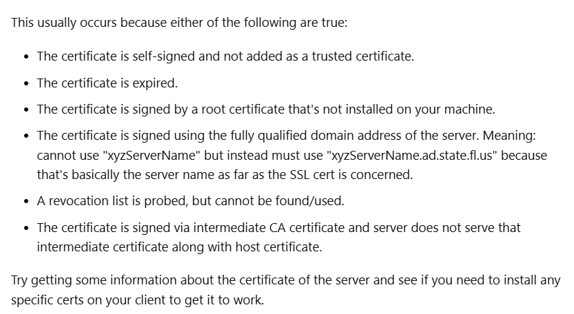

If the error’s coming up on your side, this points at a problem with the cert on Epicor’s side…or at least that’s how it reads to me. Googled and found this on StackOverflow…maybe a clue? [Or am I clueless? :)]
