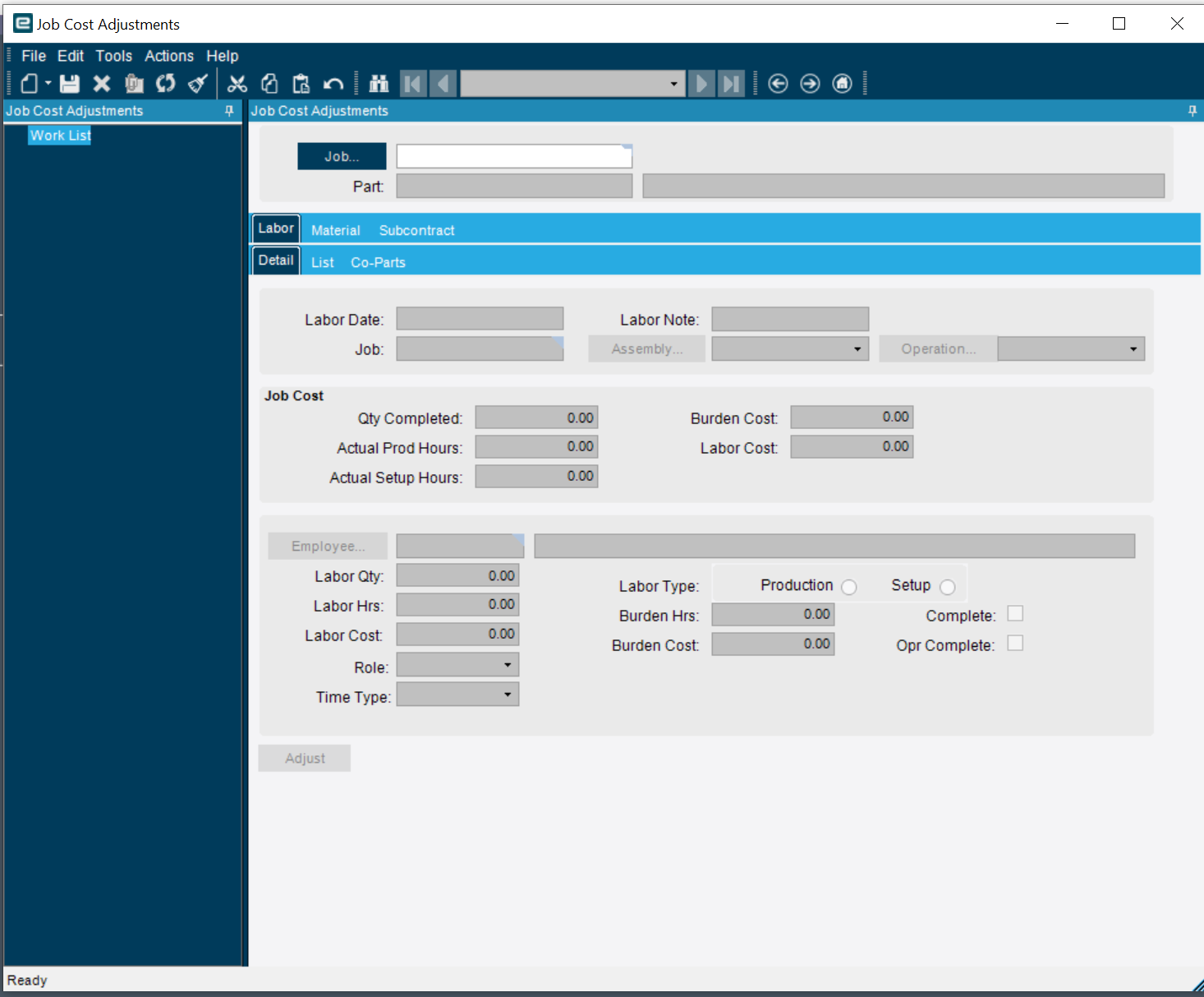

You can use Job Adjustment to adjust labor. This can correct the job costing without creating new T/E records or affecting the employee’s payroll hours.
Like I said in my edit from above…it is something that I should know and have done before…and it is :slight_smile:
You’ll have to zero out the cost and time fields in Job Adjustment, and then re-enter them in T&E
Production Management > Job Management > General Operations > Job Adjustment
Could do it all in Job Adjustment. Negative on job A, positive on job B.
Since he completed a quantity of 239,000 for that Operationon Job A, I would enter -230,000 on it for Job A, then go into Job B and enter in 239,000…simple as that, right?
Quantity is one part of it, but if you want the hours/costs to be moved, you need to edit those fields too.
We don’t need those fields/values, but as long as I am in there I may as well do them too. No sense in half-arsing it.
