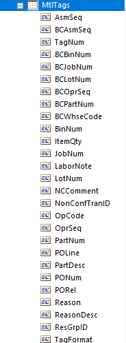

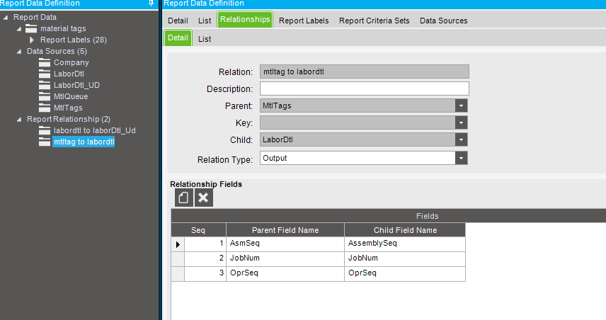

MtlTags has a DataSource called “MtlTags” which is some kind of system query source, not a database table. That’s why there aren’t any fields listed in the RDD. However, if you look at the query in the RDL, “MtlTags” it includes PartNum and PO information… which is enough.
I would ignore MtlQueue.

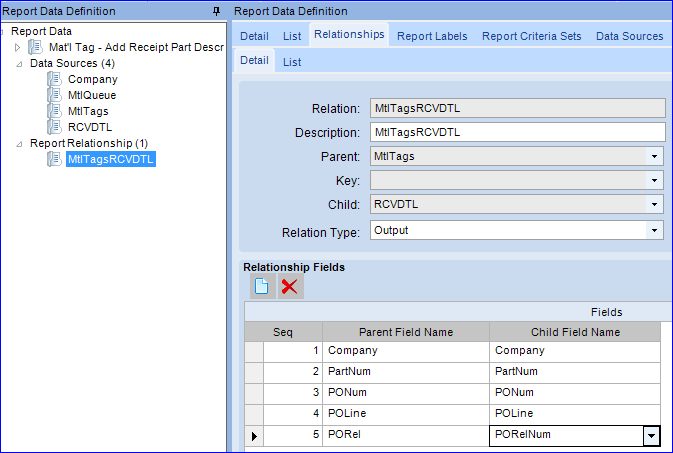

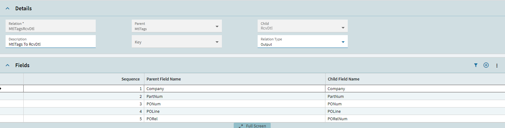

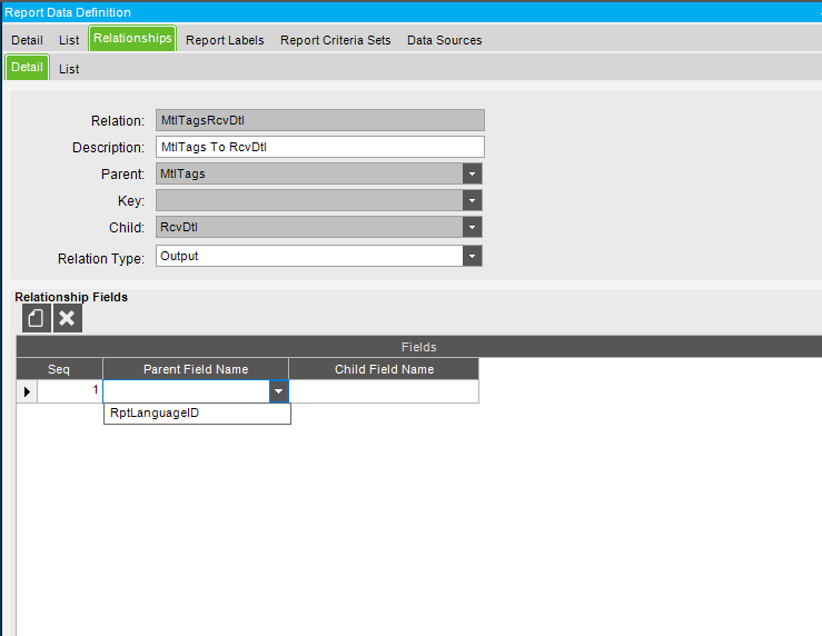

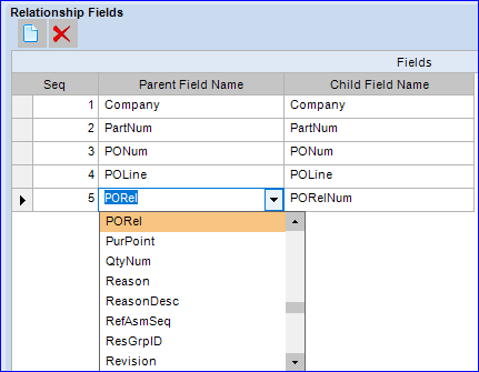

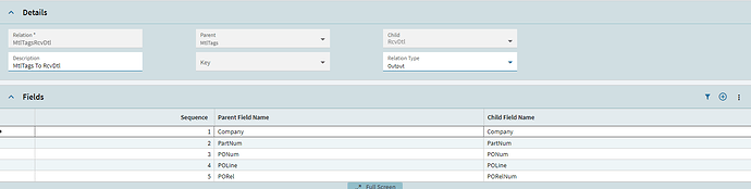

Add RcvDtl as a data source to your custom RDD with the below relationship, linking it to MtlTags.
Then you can add that join to your RDL.

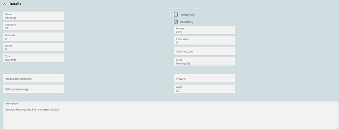

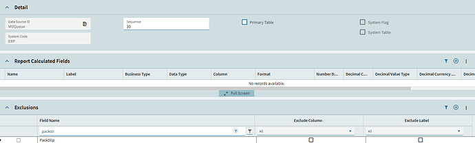

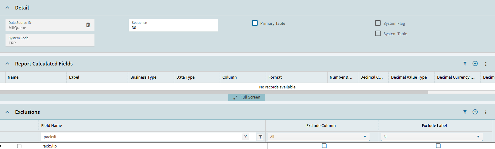

Add PackSlip as a Query Field, add it to your report where you want it, and you should be good to go.
