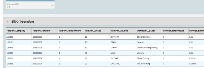

I was able to create a Panel Card Grid from a new dataview linked to a BAQ.
  1. How do I make the Panel Collapsible? It is Auto-Expanded on Load (Which I like), but I can’t seem to collapse it

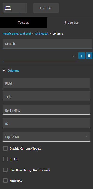

  2. How do I move columns around. The column positions are locked. I found the Grid Model > Columns section, but this seems to force to add each column back in one at a time. And once entered it doesn’t seem like you can you can change the order. Something I found out the hard way when I realized I forgot to add my second desired column.
To change the order of columns and the format of numbers you have to add each column manually in the order your want. That is what I learnt in the Application Studio class the last time unless they have changed since then.

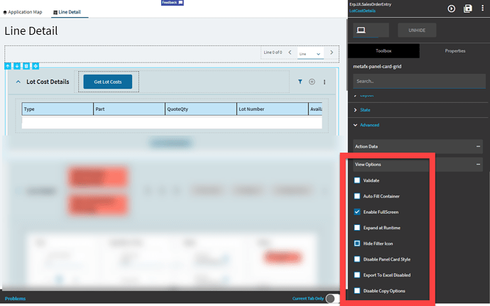

It looks like you marked your panel card grid as “Disabled”.
Enable the grid and you should be able to collapse the panel and reorder columns.
Maybe this will help…
Took a look and disabled was not checked
