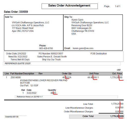

I’m trying to modify the number of zeros being printed on the SOForm. I have tried going to the text box properties and making it a number, decreasing the decimal places down to two, but I have not had any luck. below is a picture of what I would like to accomplish. Thanks.

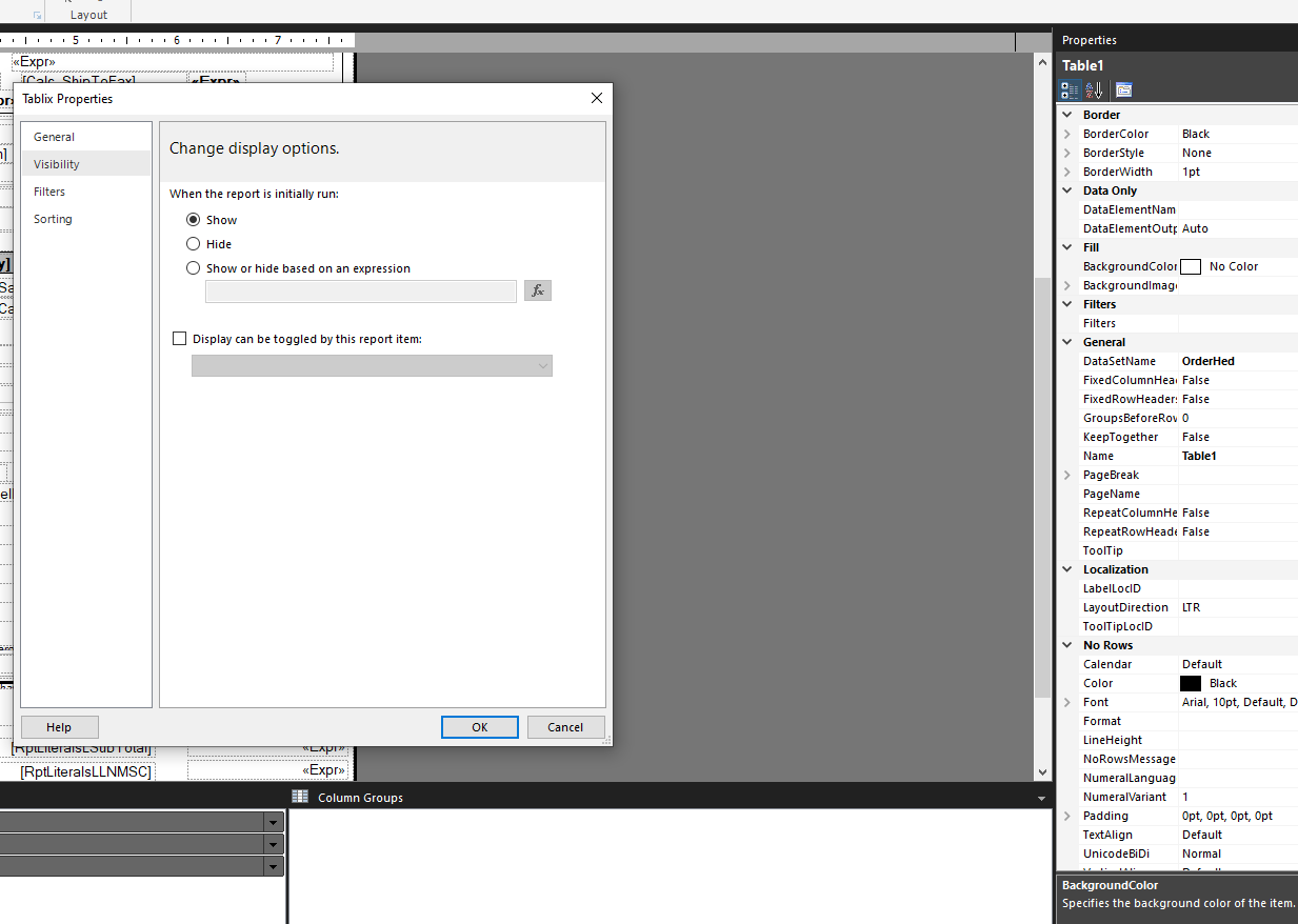

Here is a pic of the only table1 one I could find. I am not clicking on any exp boxes, rather I hot control Z after expanding something and I noticed Table1 showed up. Seems like Michael might be right. But I don’t see any expressions on the tablix properties.
Look under Visibility. There is probably an expression there which is the cause.
Unfortunately there is nothing there.
