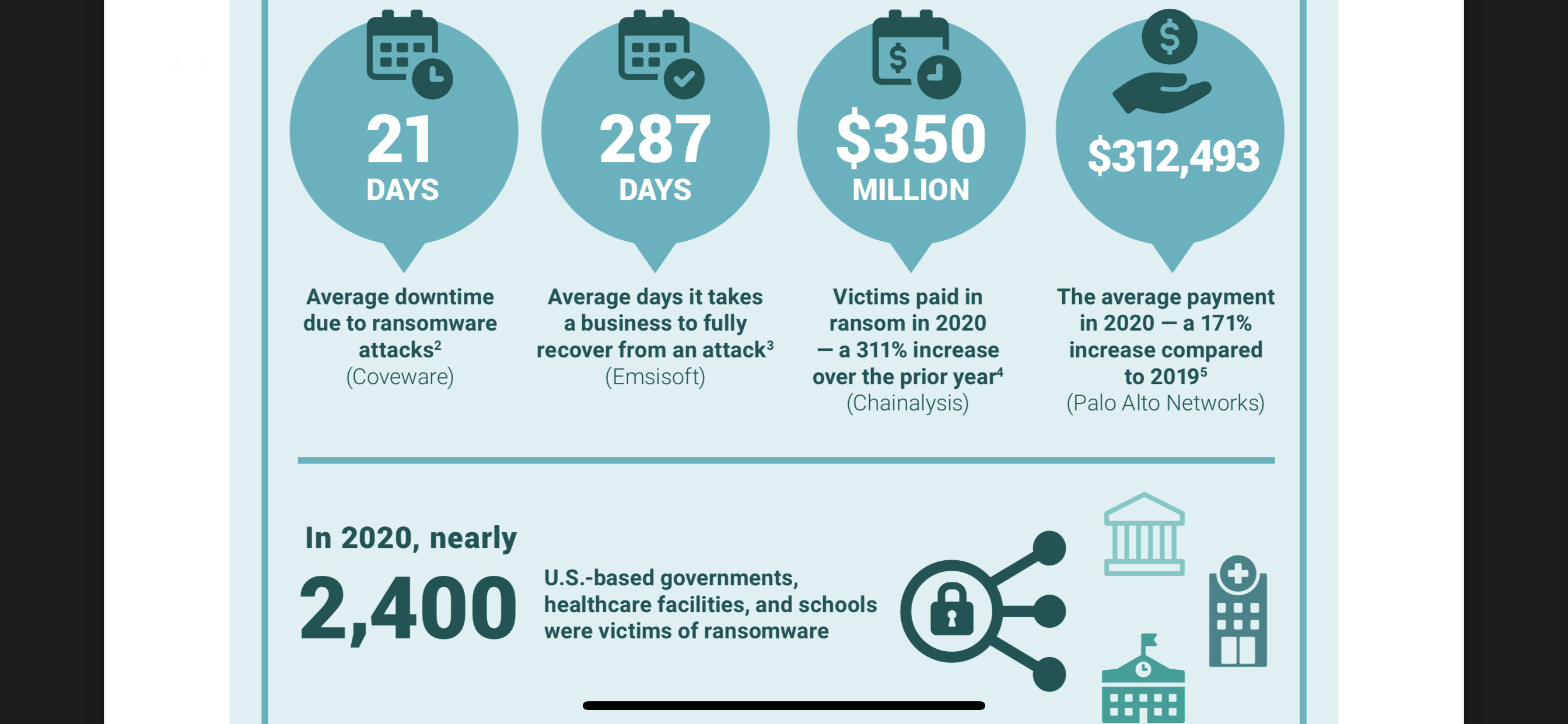

Jose it sounds like you’re a little more comfortable with ransomware risk than me. For us, we can’t afford 21 days of downtime. My approach to security is that we don’t fill our fortress with windows and say “well, its ok there are locks that usually work” or “these windows are just as secure as those windows”. We remove all windows from the fortress, commonly called “reducing the attack surface” in the security space. Exposing your live ERP to the internet is one such window that we do not want in our fortress wall. Not everyone wants to spend the time and money to do it that way, I guess it depends on how much 1 hour of downtime costs each individual company. But that is our approach and it has kept us out of trouble many times. We watch as Azure and others have extended downtime while we keep chugging along with zero downtime.
Source: https://securityandtechnology.org/wp-content/uploads/2021/04/IST-Ransomware-Task-Force-Report.pdf
