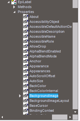

Or maybe you can set the image. It’s not in the properties pane. but the Object explorer shows a property
BackgroundImage for label controls
The run time styler lets you add an image to the control.
So you might beable to make a new style for just the EpiLabel, and set it in the customization.
If you want to get fancy, have a routiune in OnLoad, that finds all the controls with ToolTipText, and set their style to the new one.

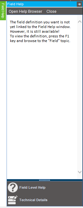

I still prefer hijacking the Extended Properties / Field Help and teaching the user to simply use Field Help to look-up “notes aka tool-tips” :slight_smile:
There becomes an expectation that you will do this on every customization :slight_smile: and you will wrestle alot with 10.2.300 Cosmetic Validation Warnings (which is new).
Can the “Field Level Help” be changed on UD fields?
I see what you mean about the other tab though, but not sure our users wouldn’t just :man_shrugging: :woman_shrugging: instead of putting in the effort to open Tech Details.
Lol, you know as well as I do that they won’t.
Hovering over an icon is much faster than going up to the field help.
It’ll be much more readily adopted.
