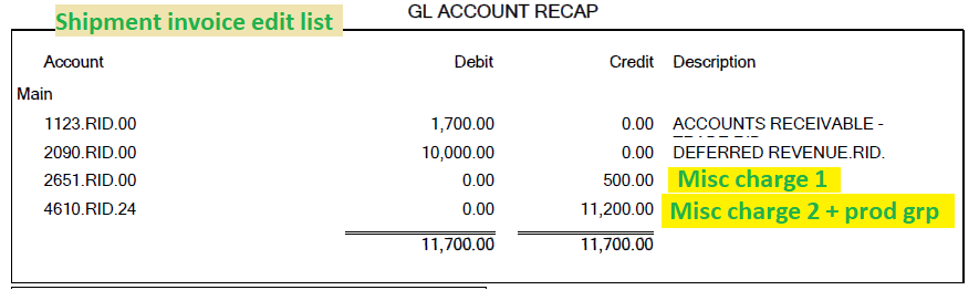

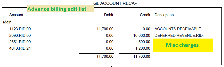

Oh, it is. But I want the advance billing line to be (11,700) so that the shipment invoice is zero.

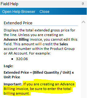

The goal is to advance-bill the line AND advance-bill the charges. But I think the moral is that you should not itemize the charges on an advance bill. Apparently you are supposed to simply tally it up on a scrap piece of paper and then key in the line total as the line base amount and apply no misc charges to the advance billing invoice.
I think the accounting is not desired, also.
For the $1,700, AR gets debited twice and the charges are credited twice.
Yeah, it looks like we are misunderstanding the use of misc charges in this instance. I think that settles it.

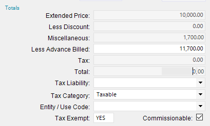

Did another test with an ADV for the full amount (no misc charges on the ADV) and it gives me the full 11.7k in the SHP invoice.
OK, so they should really disable the ability to do misc charges on an advance billing invoice!
