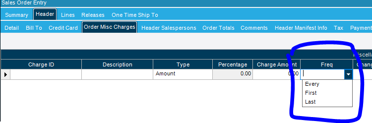

@dr_dan
May be you can try selecting “First” or “Last” frequency.
  • First – This is a one-time charge applied to the first shipment on the order.
  • Last – This is a one-time charge applied to the last shipment on the order.
  • Every – This is charge is being applied against all shipments made from the order.
We were using First.
