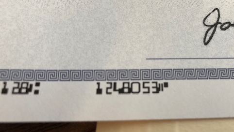

Can you take a picture / screenshot what you mean by close.
In addition, if you have a Test Environment can you go and create a Dummy Payment Group and Print to another Client Printer. You could even Print to an PDF Printer which will create a PDF.
Have you used GnuMICR-0.30 all this time? It looks like a few more folks overall have some issues with this font. The Creator even states
I have not had this font professionally tested. Use this font at your own risk! MICR printing is a very tricky business, and it requires a very good printer and magnetic (MICR) toner to do it properly
By the way this is the Font I use with Wells Fargo MICR E13-B Font for check printing
You can see here that the symbols are too close together.

Your RDL font size for those are set at 11.8pt – maybe it has trouble figuring its text-spacing try going to just 12pt. Odd if you have used it all this time and it just started.
Changing the font size was one of my guesses too, but it didn’t make a difference.

All I can still recommend is try a diff MICR Font, download the Trial MICR E13-B Font for check printing
Also they do recommend 12.5pt now as font size.
Thanks. I think I’ll give that a try.

Hey, thanks everyone, especially hasokeric for the help with this issue.
Buying the MICR Font you suggested and reinstalling it on her workstation and the server has resolved the issue.
