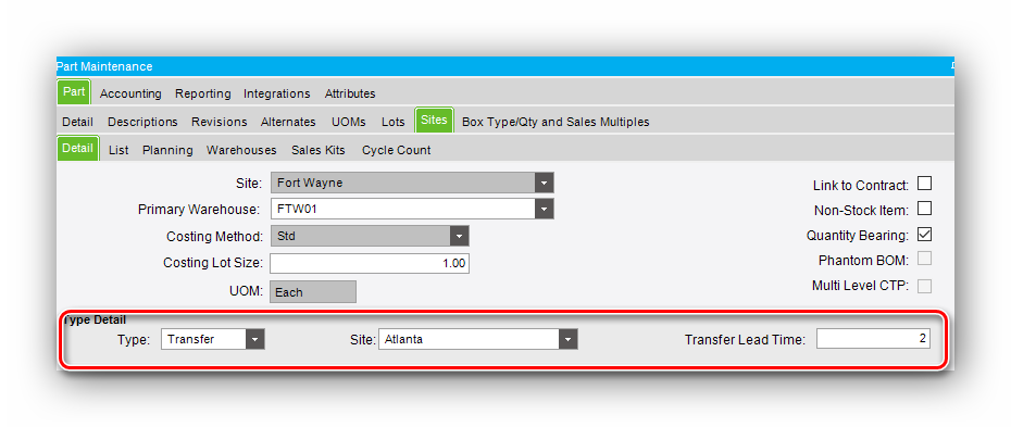

Can you set up the part in Site B to be Transfer?
:scream:
All this time, I never knew that was an option.
Now I need to to integrate this into our configurator:
  1. Make new Part entry in site A
  2. Add all other sites to part
  3. Set all other sites to type Transfer
