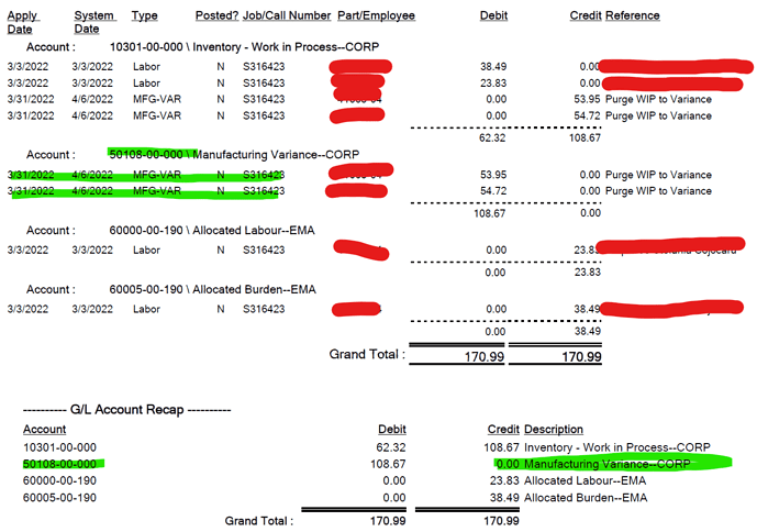

So finance just closed many jobs and recorded MFG-VAR transactions to the GL accounts.

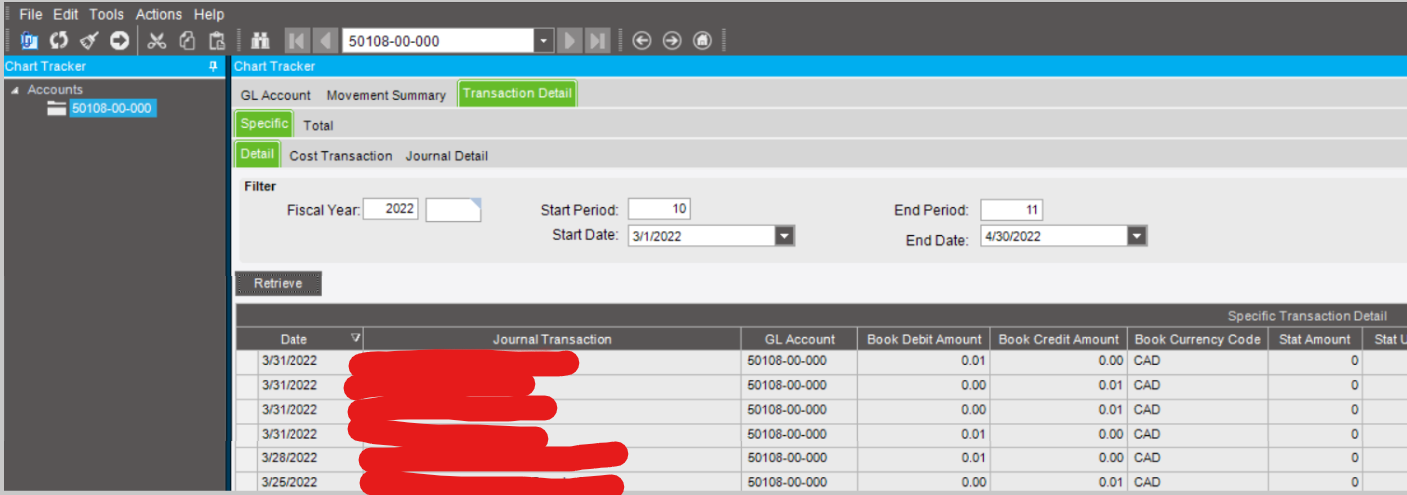

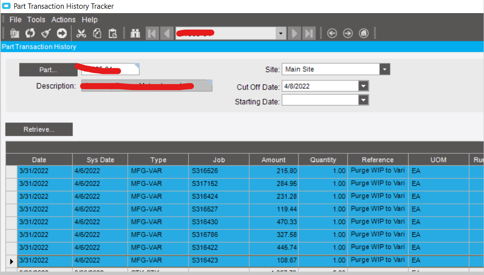

The problem is that I can see the transactions posted on the Part Transaction History Tracker but I don’t see those transactions in the Chart Tracker when looking up that GL account.
Here is one of the many parts.
(Transactions are posted in Part History Transactions)

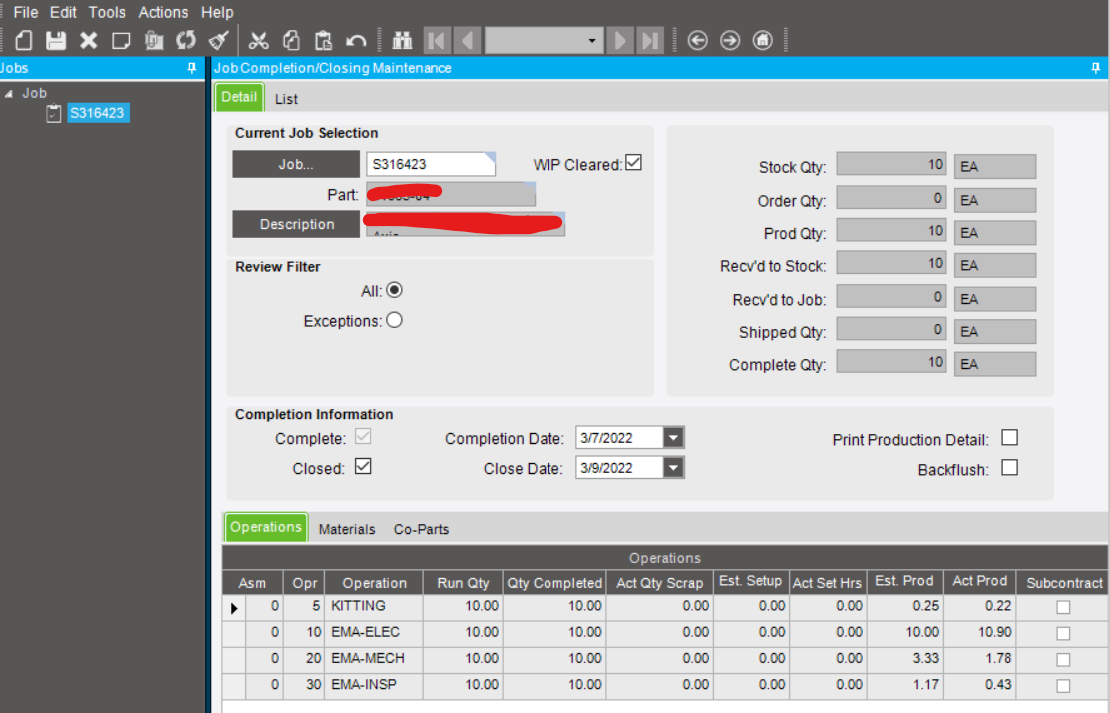

(Job is closed properly)

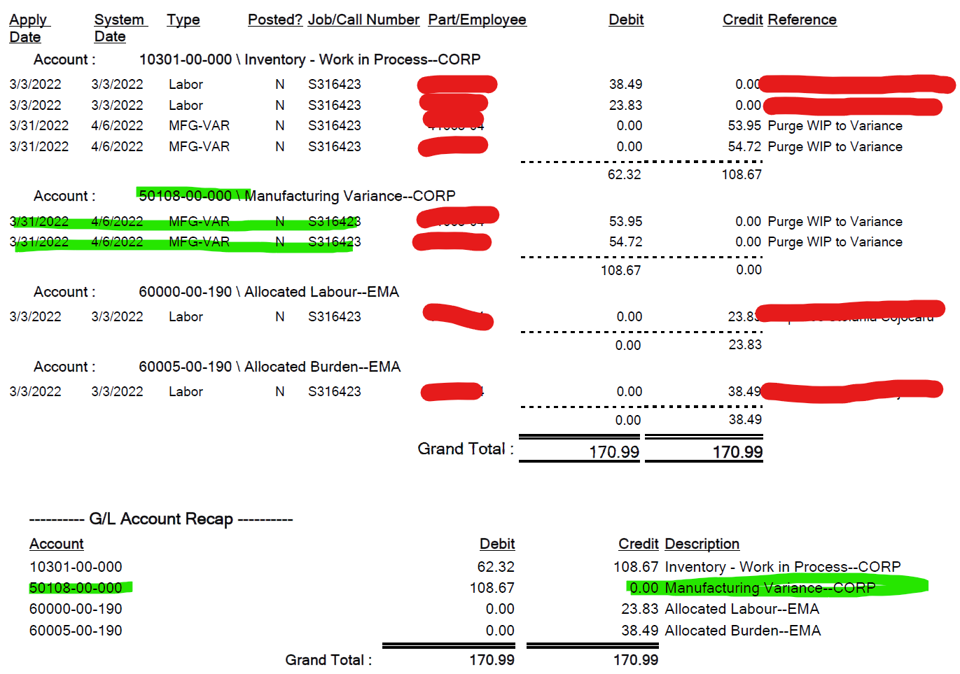

(I even ran the Inventory WIP Reconciliation report and it’s shown that the Mfg-Var transactions were posted to 50108-00-000)

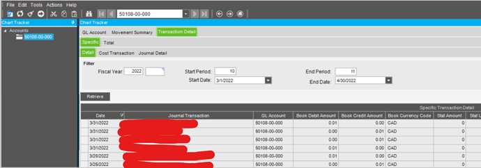

(But then in the Chart Tracker for that GL account, none of the Mfg-Var transactions show up)

On your Inventory/WIP report it shows that they have not been posted yet. Look in the ‘Posted?’ column and you’ll see all ‘N’ (No) values.
Capture WIP probably hasn’t been run.

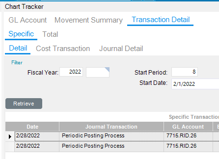

I don’t use Chart Tracker, but assuming you did run the capture, looks like you’ll see periodic posting here…
And the transactions here (I moved some columns):

@andrew.johnson I agree the report says N on the posting, but he has them in PTHT (first pic), so I think that’s an older snapshot of the report.

Thank you very much for pointing that out Andrew! That is indeed the culprit. Finance swore to me that they did run the Capture WIP and apparently they did. But the catch is that they hit an error while running it and they didn’t even know about it. I retraced their steps, clear out the error from the Review Journal and re-ran the Capture. Everything looks good now!
