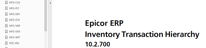

If that is the case then here the MFG transactions as of E10.2.700
I don’t see that transaction type anywhere, by any chance do you have custom posting rules?

It’s not in the Tran Hierarchy. SNTran has some types that are not in there. I took a closer look at this and, from what I can see in our DB, all MFG-PCK transactions we have were done years back when we were on Epicor 9. Also, they are always followed by a MFG-CUS. I don’t know if this helps.
