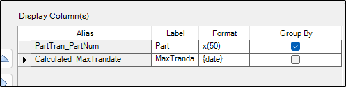

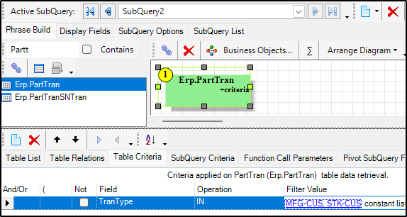

As Alisa said try something like this.
Create your sub query and set the select criteria on the TranType
Add PartNum to your display and Group BY

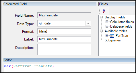

Create a calculated field for MaxTranDate
Thank you for your wonderful example - I’ve set up the Subquery as recommended. On the Top Level I have the table “Part” as I am asking for only manufactured parts and that I don’t want certain part numbers included in the result.
I am connecting the SubQuery to Parts using PartNum.
I am still receiving multiple “LastTranDates” for a single part - oh, and I am grouping by PartNum.
Sorry,
My bad should have said,
Step 1

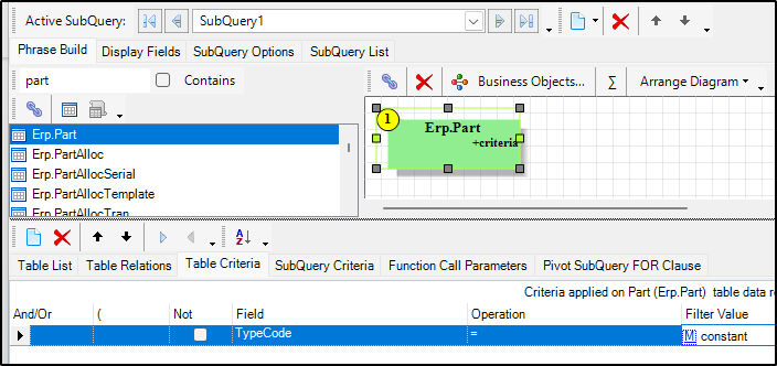

Create top level Query
Add Part Table
Add Field PartNum
Filter on Type “M”

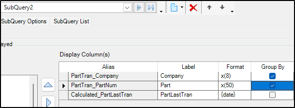

Add second SubQuery for Transactions
Add PartTran Table
Filter on TranType “MFG-CUS” & “STK-CUS”
Add Fields Company, PartNum
Create Calculated Field for LastTran
Group By Company, PartNum

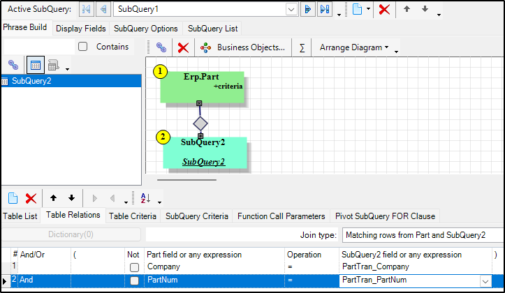

Add sub Query2 to top level query
Link on Company, PartNum
Join type Matching rows from Part and SubQuery2 to see only parts that have a transaction

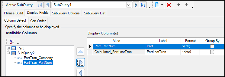

Add your calculated LastTran field from SubQuery2 to SubQuery1 display fields
Run the Query
Wow - looking good so far. I learned some finite details that I wasn’t making. Seems that I had the correct choices but did not have them pulling in the correct order.
