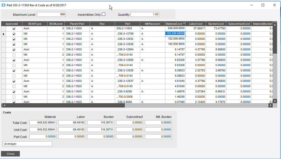

This was going to be a question about where the method tracker gets the costs for the materials, but I figured out that it’s looking at the revision, even if it’s a purchased part. Now I have a different question. If we have custom parts that are modeled, they get imported into E-10 with materials on them (the amount is 999999999 or something like that for length materials, long story as to why). Then it’s decided to outsource due to various reasons, so the method never gets built, because we shouldn’t need it, the part is purchased. But now it looks like the view cost is still looking at the material in the revision rather than the cost of the actual purchased part. Can anyone tell me if there is some logic to be able to control this so the view cost looks at whether the parts is purchased or manufactured? I’ll do some trial and error stuff, like put a cost on the part, however if someone knows the hierarchy (or where to find it) that would be helpful.

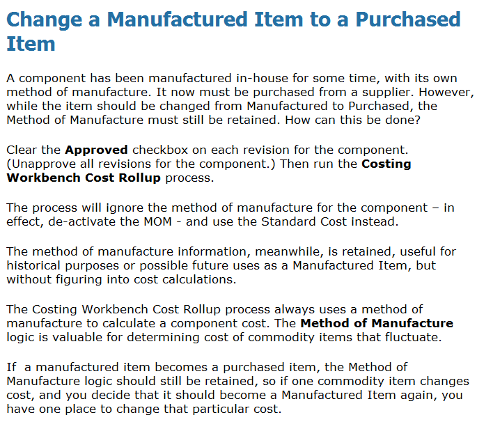

I’m not saying that it’s not possible that there is some hidden logic or field affecting what it’s reading, and from reading the help snippet above, it seems to mean that, but I suspect that the help article is referring to the cost roll-up report and not the Method Tracker view cost screen as far as whether to look at the revision or not. Even if I un-approve the revision, the view cost screen still looks at the revision cost, not the costing method cost.

costing method is average, qty on hand is 0 and current cost in the system is 0. (per the screen shot above) Part cost is 0 because the parts were purchased directly to the job. I tried posting costing rollup in test, although, like I said I am probably doing it wrong. If I delete the revision, however, the view cost screen in method tracker will change, which is why I don’t think it’s tied to costing roll-up other than the fact that it updates the part cost.

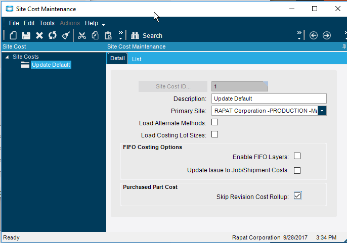

There is a check box in sit cost maintenance that says whether to skip the revision for the cost rollup. (the bottom one in the screen shot). I’m going to do a little looking to make sure it doesn’t mess anything else up, but preliminary tests look like it makes it behave the way that I would expect it to.
