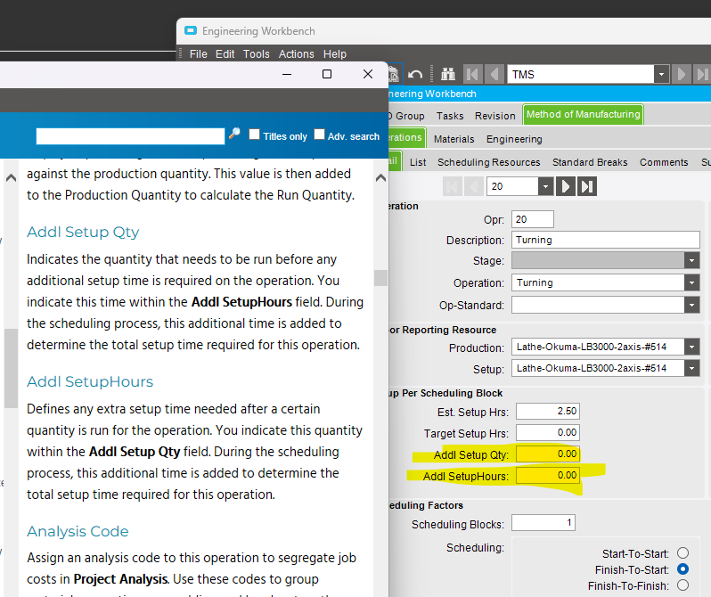

If this were me, I would set up the following:
Part Entry > Part Plant > Manufacturing Lot Size: Set this to 104 (your job size)
Engineering Workbench - Method > Operation: Set Addl Setup Qty = 4 and Addl Setup Hours = 0.12. Also set Est Setup Hours = 0.12.
For the cycle time, I would set the Prod. Std. to 10 Minutes / Cycle and then set the Pcs/Cycle to 4. This should let Epicor do the math to figure out it takes 10 minutes to make 4 parts.
EDIT: It looks like you can only select Cycles/Minute or Cycles/Hour, so I would put in 6 Cycles/Hour here.
The additional Setup Qty and Hours allows Epicor to add setup time to the job based on the Production Qty. See here for another example of that.
